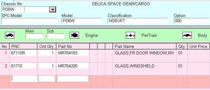

Does anyone know the actual part number to replace a windshield and drivers side window? I know that it has to be actual Delica windshields but the glass shop needs a part number to get it shipped here.
I tried looking for part numbers but couldn't find any yet.
TK

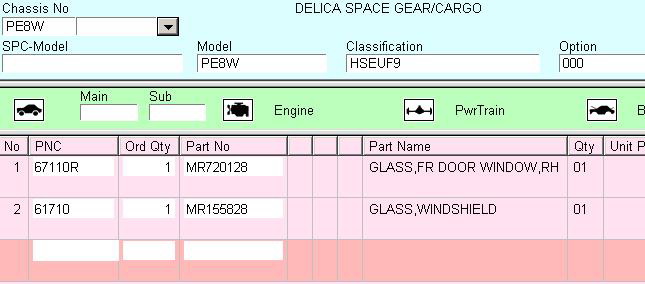

Here you go. Although your request is confusing (your profile shows '93 turbo' but you are asking about parts for an L400 and without providing the chassis number) I give you both high roof and low roof L400 parts numbers.

I'll need the same thing for my L400 Super Exceed, crystal light high roof. It has the heated wires for the wipers. Is that the same number or is it a different one?

MR155828 comes a wipers heater.
Why don't you guys install MMC ASA and find all the part numbers yourself? This has been published on our forum over a year ago.
