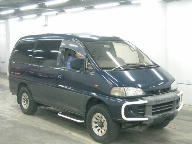

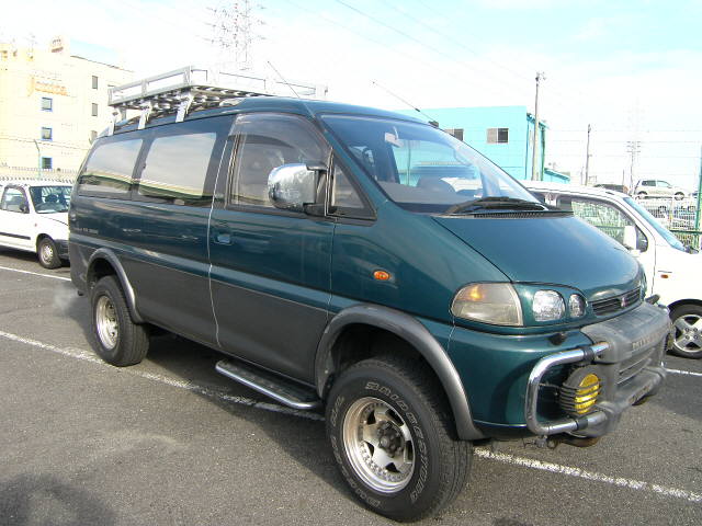

See three examples below sold at auction for less than 100,000 JPY.
The shiny lifted black one sold for 63,000JPY = $813 CDN
Any of those three would have cost you 320,000 landed (100,000 car/100,000 fee/120,000 freight)= $4,100 CDN
You're looking around 1/2 the price to import one yourself.
The private/dealers selling them here for 9-11k are making some good coin on the V6's.
Wait a few months and you can nab a 2nd gen one with a mild facelift. (november 1997 - onwards)
