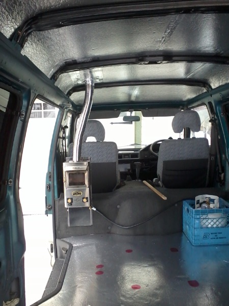

I am still very early on in my camper Delica project, but I had really good luck with "Durafoam" for the floor and ceiling. It is closed cell foam with just enough flex to fit the contours of the roof, and the 3/4 inch sheets tuck into and under the side roof beams well. I sealed the seams with foil tape. The foam has plastic on one side and reflective foil on the other. Much warmer already, and not expensive, 4x8 sheet was $12 at Home Depot. This foam is not as resilient as some closed cell foams, so I will not use it as my flooring, there will be a layer overtop and some cabinetry to follow.
I would like to finish the interior as shown on the excellent site for DinoEvo, ( http://dinoevo.de/ ) It is a very inspirational and well done job, the site and the van! However this roof and floor insulation could work with the standard plastic interior panels with a little creativity.
Best Luck to anyone converting their van to a camper.
Adam
Adam
- Durafoam insulation.
- Photo0057.jpg (84.05 KiB) Viewed 8029 times
Re: L300 insulation with stock interior
Dickson heaters are awesome. We have an Alaskan in our cabin.
I've never seen one in an L300. Good job !

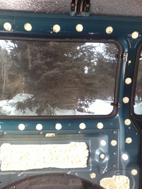

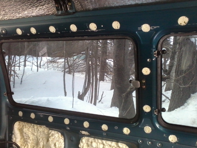

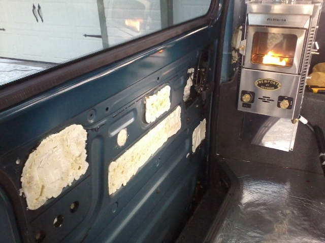

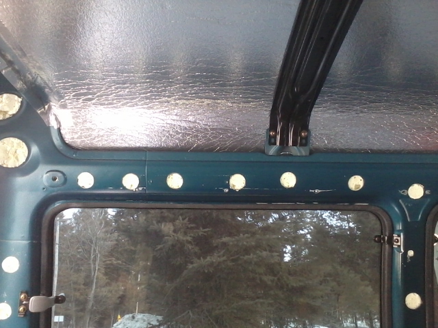

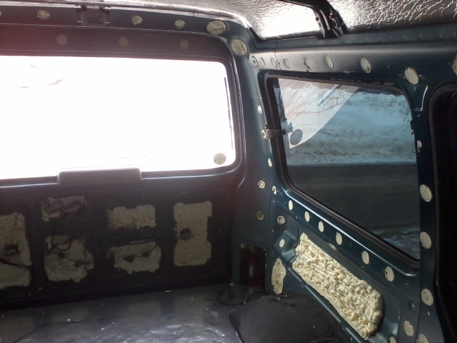

I am just finishing the second part of my Delica insulation, the pillars and panels. Next will be window covers. My goal is to have a really comfortable, warm interior, suitable for extended winter use. I also want to make maximum use of potential living space, so insulating the cavity inside the panels and pillars was the best route for me. In regards to the original posting, this method would also be compatible with the stock interior plastics and panels.
Of course, access is an issue. I got around this by using a 1.5" and 3" hole saw to drill access holes in the tricky to fill sections. Good accessibility and the ability to visualize the work surface meant that there was no guess work in how the spray foam was being dispersed; I wanted full contact with all metal surface areas to eliminate air pockets and potential moisture traps. The foam is applied in layers, from exterior metal to interior, to minimize voids against the outside sheeting. Once in place and cured, the foam is essentially waterproof, and has an R-value that is very desirable. Removing the interior panels, wires, and tail-lights gives pretty much full, if sometimes awkward access to the areas needing insulation.
The holes end up neat and tidy, once the foam is trimmed. The panel sections could be sanded smooth, but I don't mind the lumpy appearance as everything is going to be under the finishing work, eventually. Panels which used to hold vents and controls will be replaced with flat closed cell foam insulation; more on that later.
Best of luck on your Delica mods;
Adam
Adam
I would strongly discourage others from cutting large holes in the primary structure of the vehicle unibody. Based on the photos its too late to do so for AJ.
AJ Boombox
- Posts: 9
- Joined: Sun Jan 08, 2012 1:40 pm
- Vehicle: L300
Rich D has a very good point, and anyone considering a mod like this should think carefully about it. It is a tough decision to make, but my needs for insulation are very high compared to most. My van will never carry passengers in the back, all rear seating has been removed and will not be replaced. I did not drill into the pillars or beams above the driver and passenger area, all roof supports were left in place, and the location of extra stiffeners and thicker potions of metal were noted and avoided. Basically, I am treating my van's rear cabin as though it were structurally a truck box and cap, a space to haul and camp in, but not for use while in motion. Plans are to put a roll bar behind the driver/passenger area where the rear ac/heater duct work used to be.
I should have put the caution Rich did, along with my post.
