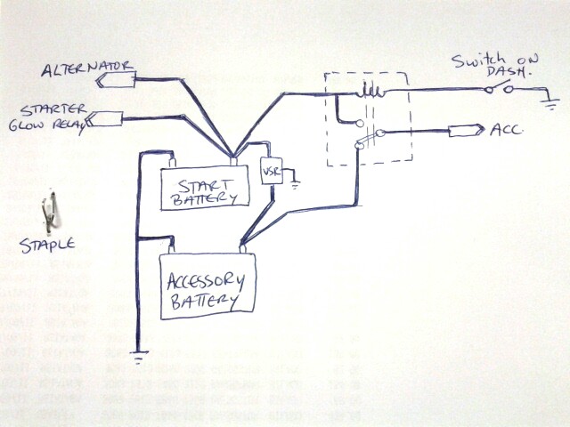

Here's my solution to the problem. I'll explain it in the next post as the image is from my phone and typing is hard .

Re: Battery isolator
The starting battery is connected to these original cables:
-Starter/Glowplugs (black cable, no labels, 2x fusible links coming off it)
-Alternator (black plastic box with "ALT" label, giant fuse out the back)
as well as one large cable that goes to the VSR (I'll explain that in a bit)
And one smaller cable that goes to the coil and normally open contact of a 30 Amp relay.
The accessory battery is connected to the VSR, and to the original accessories cable (black box with LOCK, ACC, errr.. lots of white writing on it. Can't remember exactly what)
The VSR is a Voltage Sensitive Relay, used in marine applications to isolate 2 batteries- when the starting battery is charged/charging it connects the two batteries together, but if the starting battery voltage drains to 12V it separates the batteries.
So, how it works:
Normally the starter battery runs ONLY the starter motor and the glow plugs, the accessory battery runs EVERYTHING else. I can drain the accessory battery as dead a doornail and still have a fresh battery to crank the engine. However, because the accessory battery runs the glow ECU, fuel pump shutoff solenoid, and other things that are kind of important for starting, I've added the 30A relay and a switch on the dashboard to turn it on. Flicking the switch powers up the relay, which connects the accessories to the starting battery.
I have no need to use both batteries in parallell for starting- this setup won't do that. But it was fairly easy to install
Here's the VSR I used: http://www.discount-marine.co.nz/shop/i ... ts_id=1767
Pictures of install here: https://picasaweb.google.com/1171804076 ... directlink
(Ignore the blue diode-type isolator, it didn't work with the Delica's alternator, which needs to see battery voltage on the output wire to start charging)
