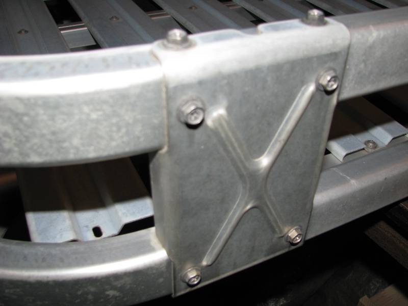

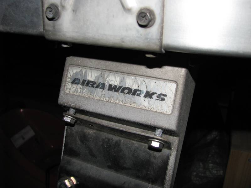

I was lucky enough to inherit an Aiba Works half rack with my van when it was adopted and have just had it sitting in my shed while I worked on brining the paint back to life. Here are some pics for those visual learners such as I:

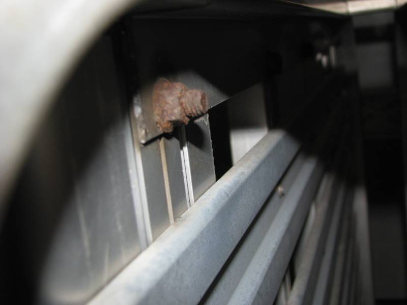

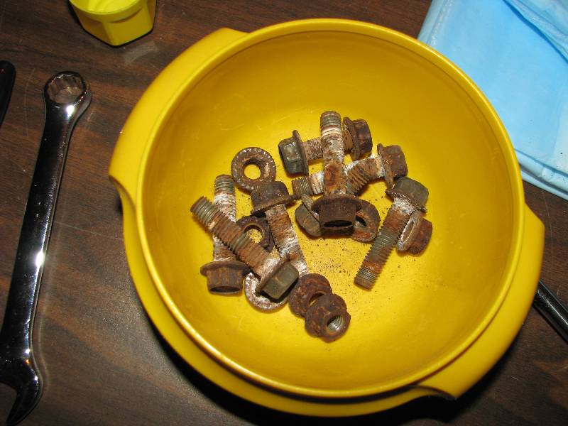

All of the hardware looked like this- decades of Japanese acid rain is my guess.

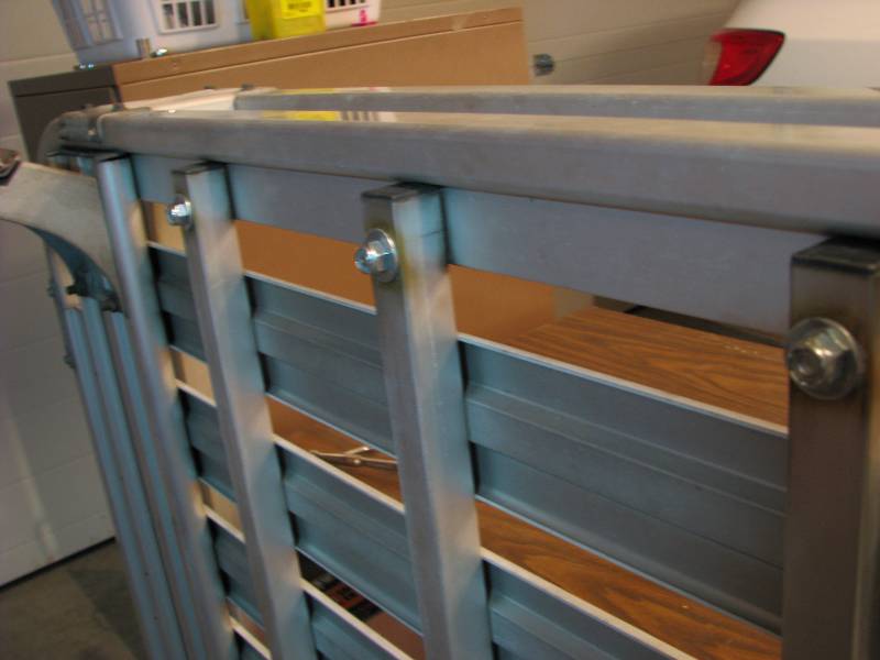

Replaced it today with nice new shiney stuff.

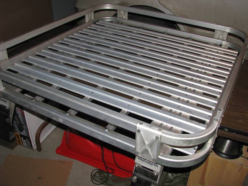

Here is what the rest of the rack looks like:
I am just wondering what the tips and tricks are to bring the rack back to it's once illustious state. How to and what to use would be great appreciated advice. Also wondering if I should replace the decals (if so where to get them) or if I should just pull them off. What do you guys think? Thanks

Metal cleaner, like Autosol; some elbow grease; old toothbrush; Scotchbite pads; power-buffer; micro-fibre towels. Aluminium is pretty soft so maybe try finishing it with something like Brasso (do a test spot in an inconpicuous area of the rack to be sure). I'd leave the decals on as a patina-ed testimony of the rack's pedigree and just clean up to the edge of the decal.
