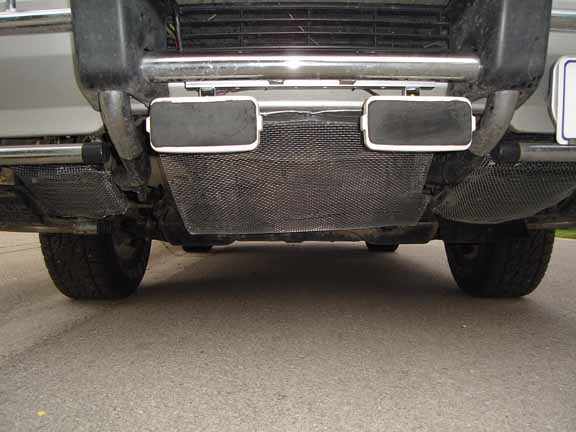

One thing I'm wondering about now are the bolts -- are they included? Today I put some quick-and-dirty protection on the underside. I used 1/4" mesh. But the bolts (looks like the same mounting method as the skid plate) are barely long enough to thread with the addition of a bit of mesh. Will they be long enough for the skid plate?
Here's what I did for the underside:
air intake mesh.jpg (49.92 KiB) Viewed 6858 times
I hope the skid plate you guys are making will replace the centre one, (or maybe I'll try to keep the mesh for added stone protection), but the side ones will stay.
For those wondering about my paranoia, the trip we are about to embark on, with Vancouver being the first stop, will have at least 1500 km of gravel road. I hope it was wasted time, but rather a bit of effort with mesh than a leaking radiator in the middle of nowhere.
The other protection I did about 5 years ago was for the foglights. The covers are just plastic, and I glued some spare 1/4" neoprene on them. That has probably protected them pretty well over the years. Yes, these aren't the stock foglights, but use the stock wiring. I won't get a chance to install the driving lights where the factory fogs where, I'll just have to live with the headlights for the trip.

To answer the question about hardware.....Yes. Stainless bolts will be included in the "kit"....lol's
Also washers for the upper mounting locations.. (also stainless) I would not want any rust stains running down the new shiny skidplates ! After trying to put one on jaggedfish's delica i might need to include a tap too !! Those bolts in the "giant manta ray mouth" of an air intake were quite rusted from 15 or so years of driving !!! (i will not include a tap,but one might be needed to make the job easier !)
The skid plate will provide protection to the whole middle area. Mesh could be added to the inside to make for a bug/gravel proof set up that would work quite nice. You could even block off the bottom row of holes in the winter by bolting on a peice of aluminum for deeper snow protection.
