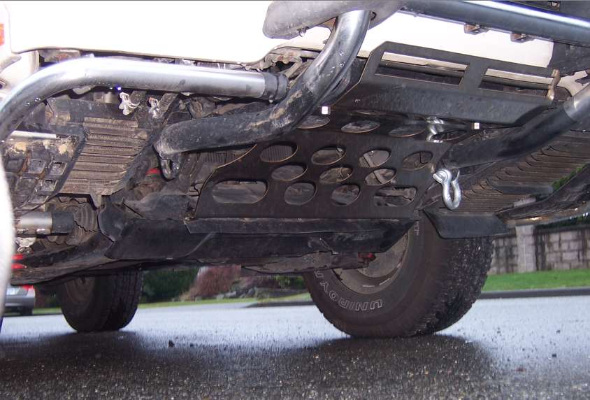

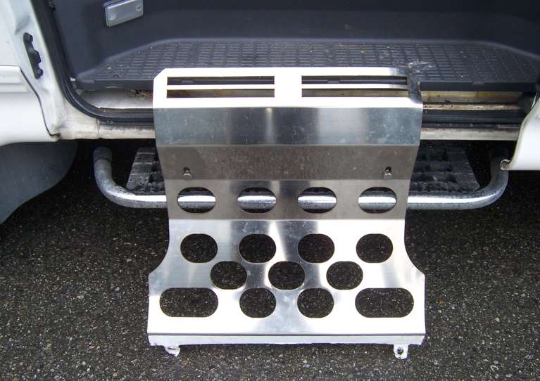

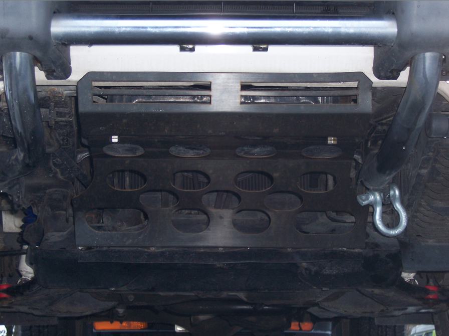

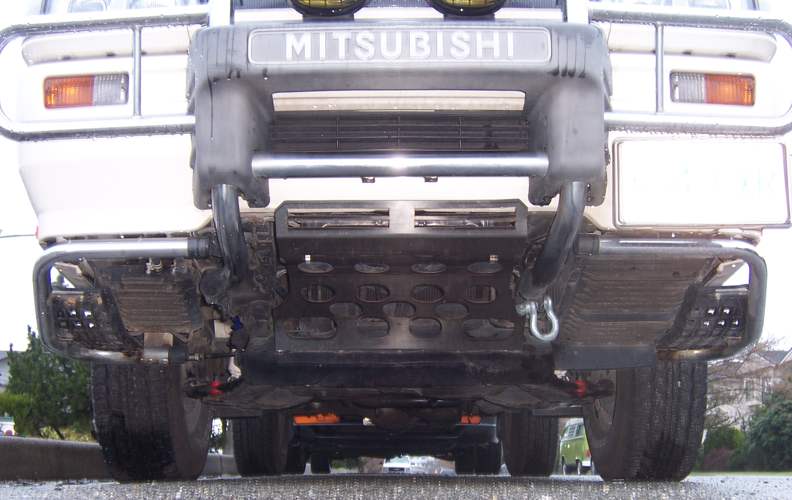

Here's a skid plate that was lent to me, (wish it'd be mine but...)
It's from Japan, made of stainless steel, it's on the thin side (about 1/8") but still surprisingly strong once attached in place. It also has plenty of air flow for the rad.
I've been looking to see how much it would cost to have something pretty similar done but in 3/16" and grade 304 Stainless. The material alone is between $35-$40/sqft, ouch! If CAD is used for the design it's $100 for the 1st one so the more made the cheaper they come. Then to cut and bend it's anywhere from $60 (cut) to $200 (cut/bend). I didn't bother to ask about aluminum as I'd be concern it could crack if banged up against rocks. And steel would need to be thicker and not too keen on the rust aspect. So Stainless doesn't rust, is stronger but more $$$. Anyone has a contact for good price on stainless?
So obviously the more we make the cheaper they get but no one will ever be happy with one single design so I need your input, maybe you can take pictures of some skid plate you see on other non-related vehicle that could help us with idea on design or material?
This design is curving inside (towards motor) which gives more clearance and won't catch as much mud but I'm sure if the curve was out (reverse than on the pics) then the belley would sit on the rock and follow the step plates. It might be nice to have the skid plate cover both little side rads but they already have some protection so don't know if it's really a concern.
Anyway, too much writing. Here's some pictures.

Looks really good and I'm interested too, for sure. I might try at adding a layer of 1/4" wire mesh over those big holes though. Overkill perhaps, but it would be an easy do-it-yourself addition to play around with and could provide the rad with a little more protection from those dreaded pointed sticks. Many thanks for the leg work and the post Delicat.

I agree, that's a pretty good looking skid plate, although I don't have years of knowledge in the subject. I'd be interested in that one as well. A few concerns, is it thick enough? Are the holes going to let sticks etc through? How many is that? A few interested parties for sure. Noel on the island and on this forum also has the skills to make something like this but stainless is better than alum. Jer
