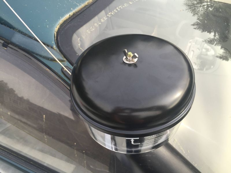

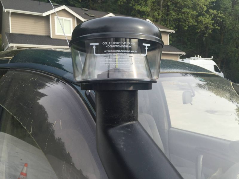

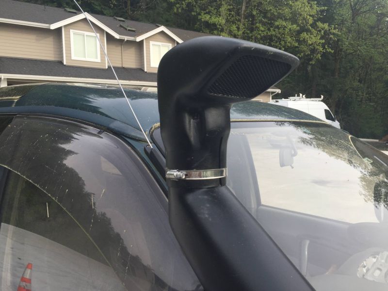

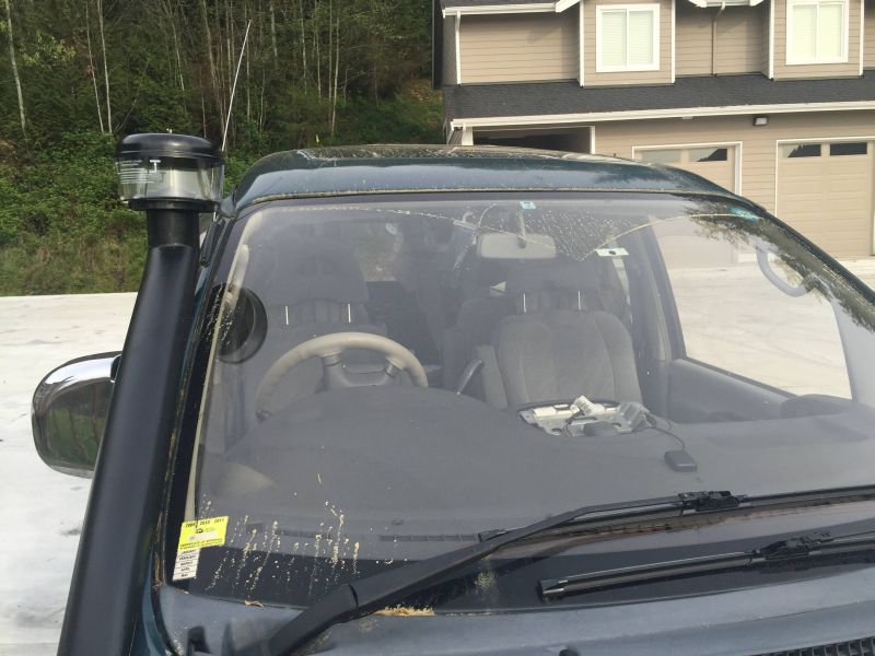

I just got the snorkel head from China. It seems pretty good actually. I will try to remember to post some photos later.
It fits perfectly into my L400 snorkel. The RAM snorkel that came with it fits on outside the snorkel, the dust-trap/cyclone head fits perfectly inside the barrel of the snorkel.
Mr. Flibble
Posts: 1397
Re: Delica snorkel group buy?
Post by Mr. Flibble »
here it is what it looks like, contrasted with the original air ram.
