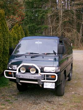

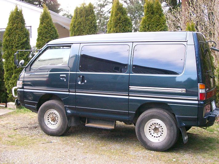

i think u can use a power steering pump off any old car but you what your rpm's the same not to high.I like Golden fuel system's one shot filter. Hey Sean is it easy to get WVO here I live in Courtenay To ive seen your van and lots of others! i just moved back here from the Kooteney's get back to me
O and heres my van you will c it around!

Re: Filtering WVO to 5 microns
Hey Green,
Welcome back. I have never seen a Delica that colour before. Looks nice.
WVO is available. There are still restaurants that do not have any agreements with anyone. We are having our first Courtenay Coop meeting this Wed. We are keeping the numbers small for the first until we decide how to proceed. Don't want to high jack this thread so check out the http://www.delica.ca/forum/courtenay-wv ... -2294.html Post for info in the coming weeks.
