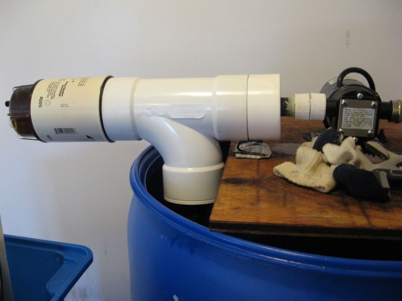

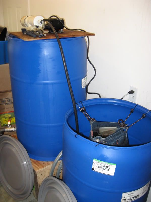

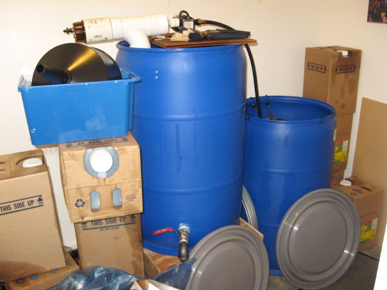

This is my setup. I use the jeans to filter out the big stuff and then pump the oil through a 2 micron fuel filter. The plumbing was designed because the metal auto part to which the filter should attach costs over a hundred dollars. I'm dreaming of machining my own out of aluminum some time.

Thanks for the pictures. Are you just prefiltering with the jeans and then going through the 2 micron filter? How long is your racor filter lasting? How much are replacement ones?
I've got a 100 micron screen that I'm pouring the cubes/buckets through, it take about 10 minutes to fill a 55 gal open top barrel. Then I stick my pick up wand with a 70 micron filter into the barrel and pump it through two goldenrod filters (both 10 micron) into another barrel. Once the barrel is full I seal it up and let it sit for weeks. I've got 12 cubes full of filtered oil, once those are empty I pump the filtered oil out of the sealed barrel through the two goldenrod filters again to fill cubes. Then I use a funnel and pour the cubes directly into my WVO tank. It saves me have to set up the pump every time I need a fill up.

Great idea for the housing for your filter, smart!! Gotta love creative solutions that don't require you needing to go out and spend $199 (it's about being a resumer not a consumer right?).
With that utility pump it's a good idea to remove the impeller and clean it once every few months. This will greatly extend it's life; an identical pump packed-it-in for me during last years Harrison Delica meet during a veggie refill.

The filter has done about 300L to date. A new one would cost about $30. I'm having leaking issues with the pump today and now I'm wondering if the filter may be done. It could also be the inexpensive pump just getting tired. Well, I'll try to solve that later.

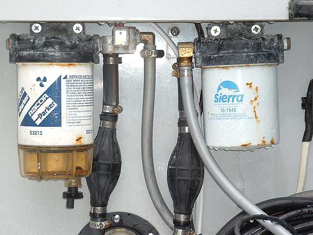

Hi Frisch, Your filter looks like the Racor filters we install on our boat(s). You mention needing to make the metal connector part instead of buying the expensive metal automobile part, have you checked what the boat kit price would be (our hunch is $100 complete kit including a new filter). Do you want Jay to check prices? If so give us your specs, and we can also keep an eye out for a used top screw in part. Cheers, Christine and Jay of the TardisDeli.
- TardisDeli
- Posts: 1425
- Location: Burnaby
Re: Filtering WVO to 5 microns
Hi Frisch, attached is photo of our gasoline (sorry) boat with racor fuel filter setup, very similar to diesel boat. You mention trying to machine a part, is this the top metal housing where the filter can screws in ? I have PM'd you with info from Western Marine. The Blue Jeans filter system definitely wins the Far-Out Cool factor. Cheers, Christine.
- Racor fuel filter with metal screw top housing.
- racor1email.jpg (38.27 KiB) Viewed 11605 times
