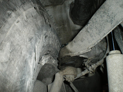

Thought I'd try to help out a little and post the pics I took today of the grease points:
Here you can see two points (picture of front wheels - taken from front of Delica - you can see two nipples here - one on the bottom of the tie-rod (90 degree nipple) and another @ about 4 o'clock on the lower ball joint)

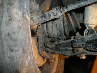

This photo shows the upper ball joint nipple on the top - like the last post said, it can be rotated using a wrench so that it's accessible without removing the tire

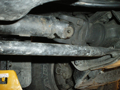

Here's a picture of the bolt that needs to be removed on the rear end of the front driveshaft with I think it was a 10mm socket. Once the bolt is removed insert the 90 degree nipple shown in the first photo to add the grease.

Thanks for posting the pics, extremely helpful. I was familiar with most of these but had missed a few - like the rear joint of the front driveshaft, I'll have to try this method of borrowing a nipple from a wheel

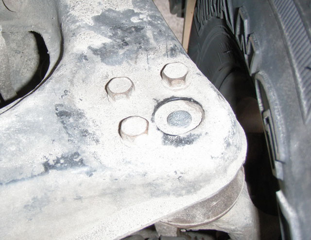

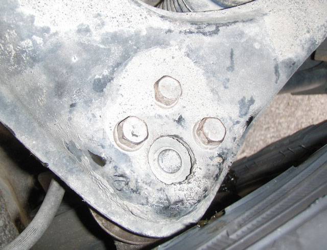

Re: grease points on delica ????
11 grease points? I doubt it, see below.
- P4260430_resize.JPG (92.39 KiB) Viewed 6114 times
- P4260429_resize.JPG (101.79 KiB) Viewed 6115 times
Sergiy, my guess is that you have seal ball joint( or it sure look like it), for my upper ball joint has a grease niple on it( instead of a shiny stailess cap like yours). my 2 cents!!
No, no, no... Please remember that nobody is perfect. Pedro is absolutely right, I was just checking around...If CVI says there's 11...then 11 it is!
BTW I am in CVI tomorrow and I can post their comments on this if you want.
Sergiy.
