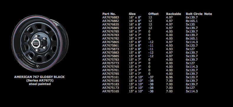

So many wheel experts in this thread. Exactly the right place to ask:
I want to keep our stock tires (LT235/75-15) but want new black steel rims. So I was wondering which from this American Racing rim is the right size?
Also Cragar has a nice steel rim, but just don't know which size to get: http://www.cragarwheel.com/catalogs_397.html
I'm also wondering what is the advantage/disadvantage from steel or alloy rims?
Thanks for your help

Felix,
Based on American Racing , the AR7675783 is the one.
But why not run down to a Big O, and get the story from the guys that do this for beer in the fridge and bread on the table.
I seem to recall JRMan picking up Rock Crawlers for cheap in North Van.
Re: So... what's the "best" tire size/lift height etc...
AR7675773 is the one you want
15x7 4" backspacing
the 235's won't fit on 15x8 rims

Thanks. Now I have two different numbers :)
I thought you need 6 bolts for a Delica.
Is it possible to mount 30" tires on this rims as well. Or is there are rim size which fit both?
Don't want to buy new tires right now, cause' mine are still good, but thinking about to change them later to 30".
