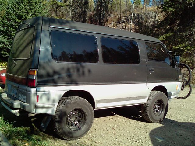

Jess is bang on of course as usual.
But I opted for the 31" simply out of aesthetics - I think the stock tires (215's if not mistaken) must be really anemic looking, and the 235's I had on originally were ok. Plus I have really enjoyed just messing around with this machine and cannot leave well enough alone, so I got a very very good deal on a set of tires & rims off craigslist and another from a friend who was "going bigger" on his Yota and "had at er". The front steps had to go of course, and I did end up having to do a considerable amount of trial and error trimming with my grinder before being "rub free" - much more than original expected but it was good therapy once I got started. I maxed out the torsion bars in the front, trimmed the bump stops to allow full suspension articulation, did nothing in the rear, and alignments is a must after this messing about.
I've currently got part of the lower trim off as well on the driver side, and will eventually be taking most / all of it off and going to Rhino on the lower 12" all the way around.
My avatar is with some American Racing wheels with too much offset in my opinion. The sliding door really could NOT open well with these.
I'm now running with a set of Pro Comp wheels and Ukranian Tire 31"x10.5x15" Roughriders - not the most exciting tire combo..but man, the price was unbeatable, and the offset is such that the door can now get to full open with only slight rubbing (one more project for the spring!). If you want to experiment first as I did - keep your eyes on Craigslist before dropping a grand or more on tire / wheel sets.
You can see by the pics that with the T-Bars cranked, I don't have a level ride - but I'm happy with it the way it is.
Oh yeah - and go with new shocks too if you think yrs aren't up to the job...made a huge difference in the quality of my ride.
Good luck.

- 04 KVR.jpg (75.64 KiB) Viewed 12239 times
