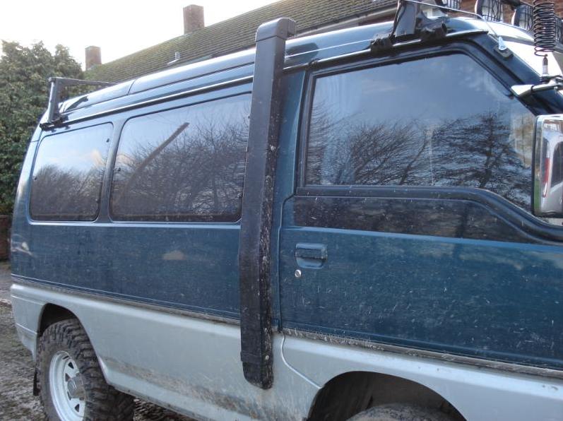

Here's a very recent install done in the UK. Nice how they kept it flat against the body...
http://www.mdocuk.co.uk/forums/viewtopi ... 235#213235
Does anyone have an idea where I can locally get some rubber 3" elbows? I've only found silicone ones that are pretty pricey so wouldn't mine cheaping out a bit... Last time I had to import them from the states but would rather get them nearby. Thanks.
Re: Custom L300 snorkel.
Home depot or a plumbing store ?
Just check the UK link, they give the details. Still looks better than the typical pvc round plumbing stuff...

hey isnt that my snorkel! :-D flat pipe looks much better than the round drain pipe on an already boxy looking L300 which makes it look even more like a shed and a chimney

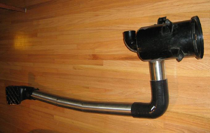

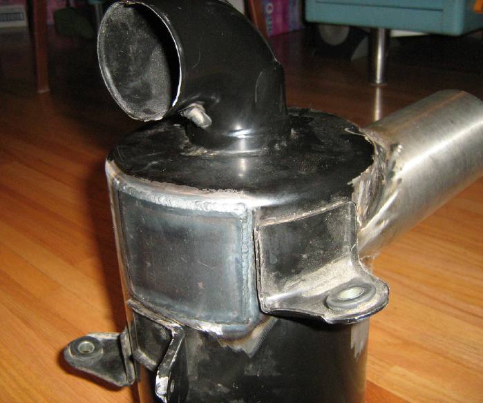

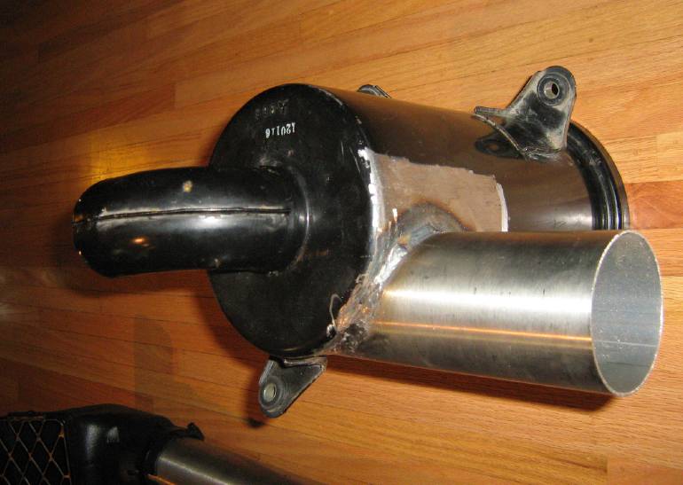

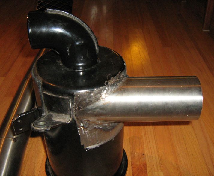

I officially started on the snorkel yesterday by welding a 3" intake pipe onto the air filter canister facing out towards the body panel and blocked the old air intake. Took a look inside the B pillar by removing the ECU, there's only the ECU wiring harness and drain pipe for sunroof (for those with such). Not much room to work but feasible. Pictures coming soon.
I didn't give up on this project... just gave up on my camera!
Here's a few pictures showing how the welded 3" stainless intake pipe was relocated to aim directly at the driver's side panel with the original air intake blocked. The new 3" intake pipe will need to be cut to fit and the brackets to hold the air canister might also need to be extended to help with positioning the whole gadget. The system his air leak tight. I did it this way as I didn't like how the original pipe had so many curves, the less the better. I also decided to keep the original air canister as it's got a nice little one-way drain valve at the bottom to keep water out where it belongs.

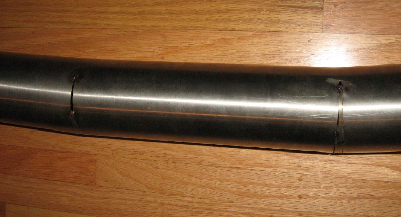

The actual snorkel pipe here is cut and tag welded for a nice wrap around the body. It's since been fully welded and you can't even see the welds anymore. Sorry, no pictures for this yet.
Snorkel 4.jpg (55.31 KiB) Viewed 28352 times
Now it's just a matter to come up with a good way to mount the snorkel pipe against the body and make it fit.

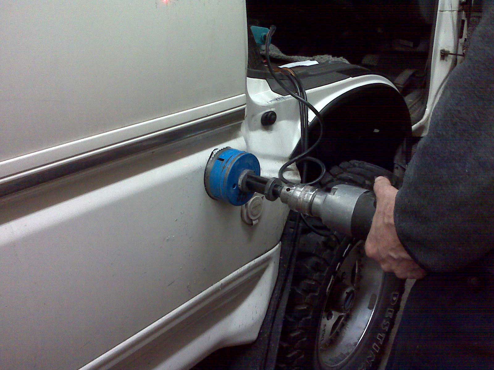

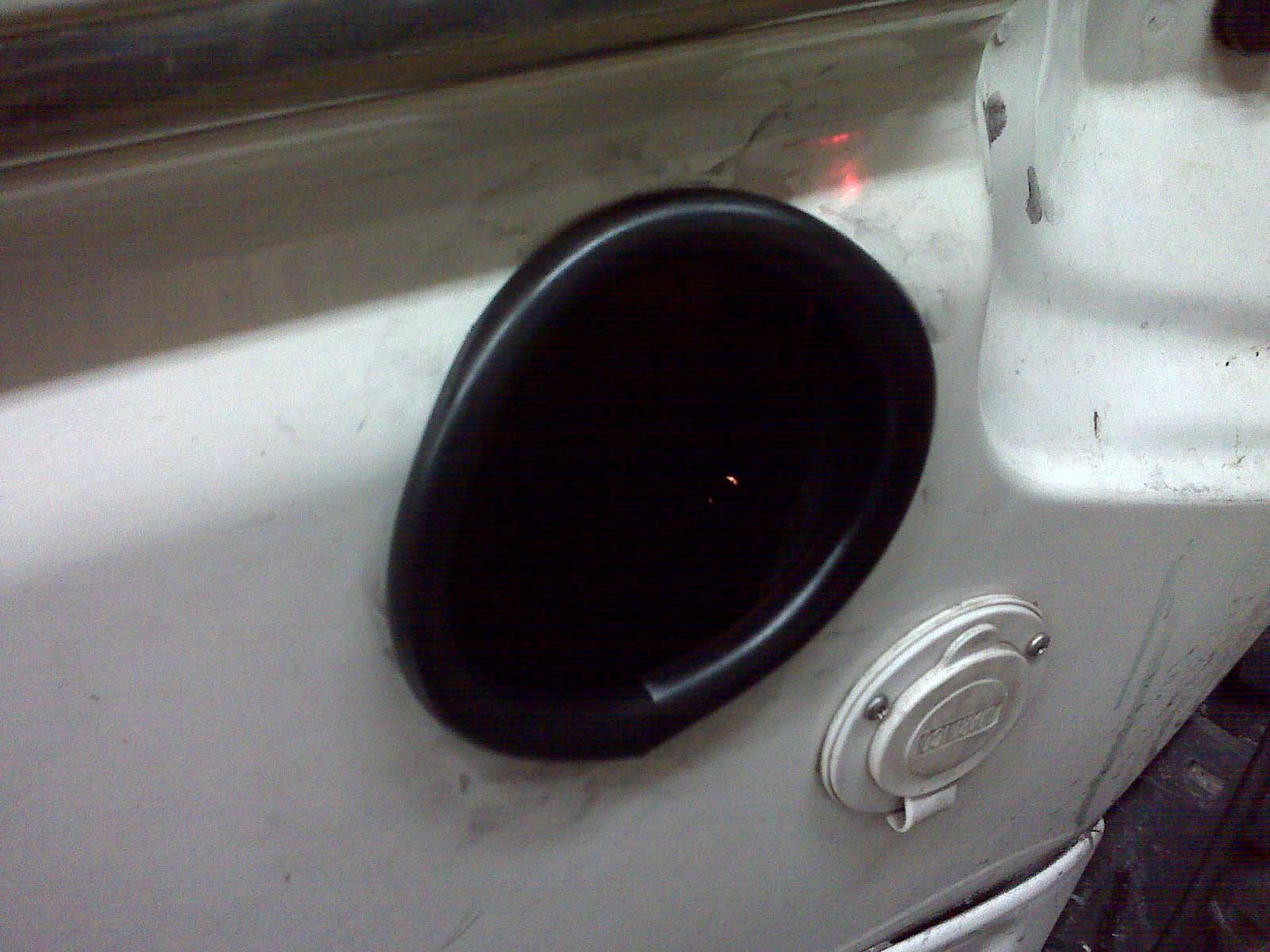

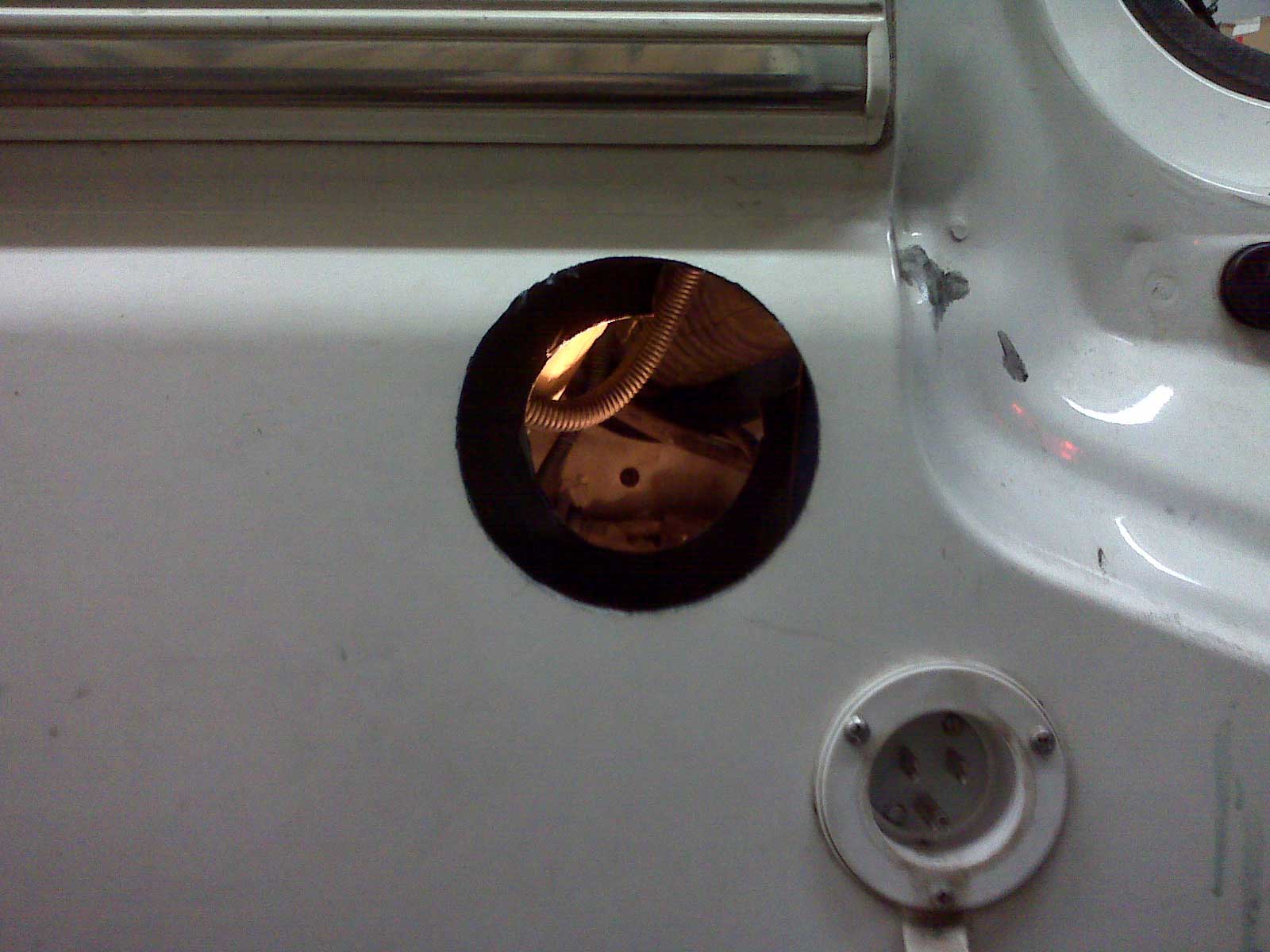

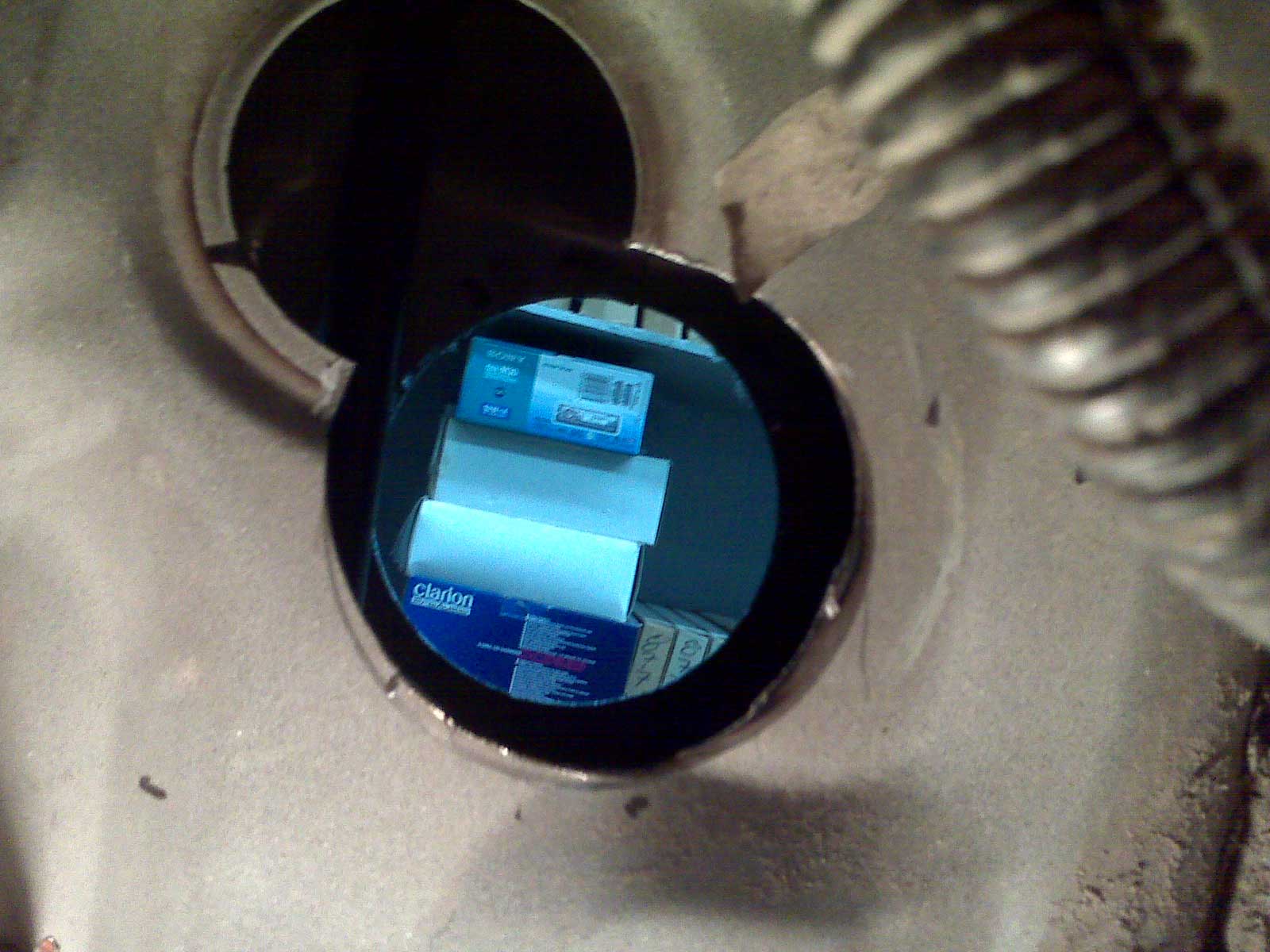

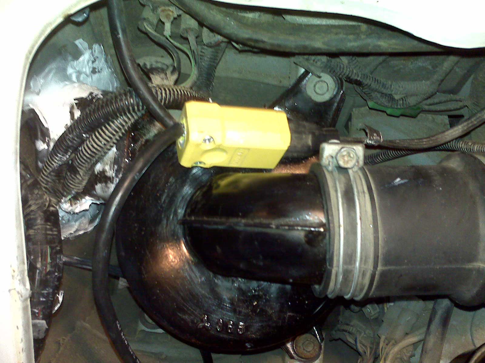

Ok, seems like I almost figured out how to retrieve the pictures from my phone. Sorry for the way too large size but can't spare time to fix it right now, sory. So here we go.
Big hole.jpg (106.32 KiB) Viewed 28183 times
Inside out.jpg (130.12 KiB) Viewed 28178 times
Canister removed.jpg (83.62 KiB) Viewed 28163 times
Padded hole.jpg (126.59 KiB) Viewed 28156 times
Sealed up.jpg (151.74 KiB) Viewed 28160 times
Sealed off.jpg (118.6 KiB) Viewed 28135 times

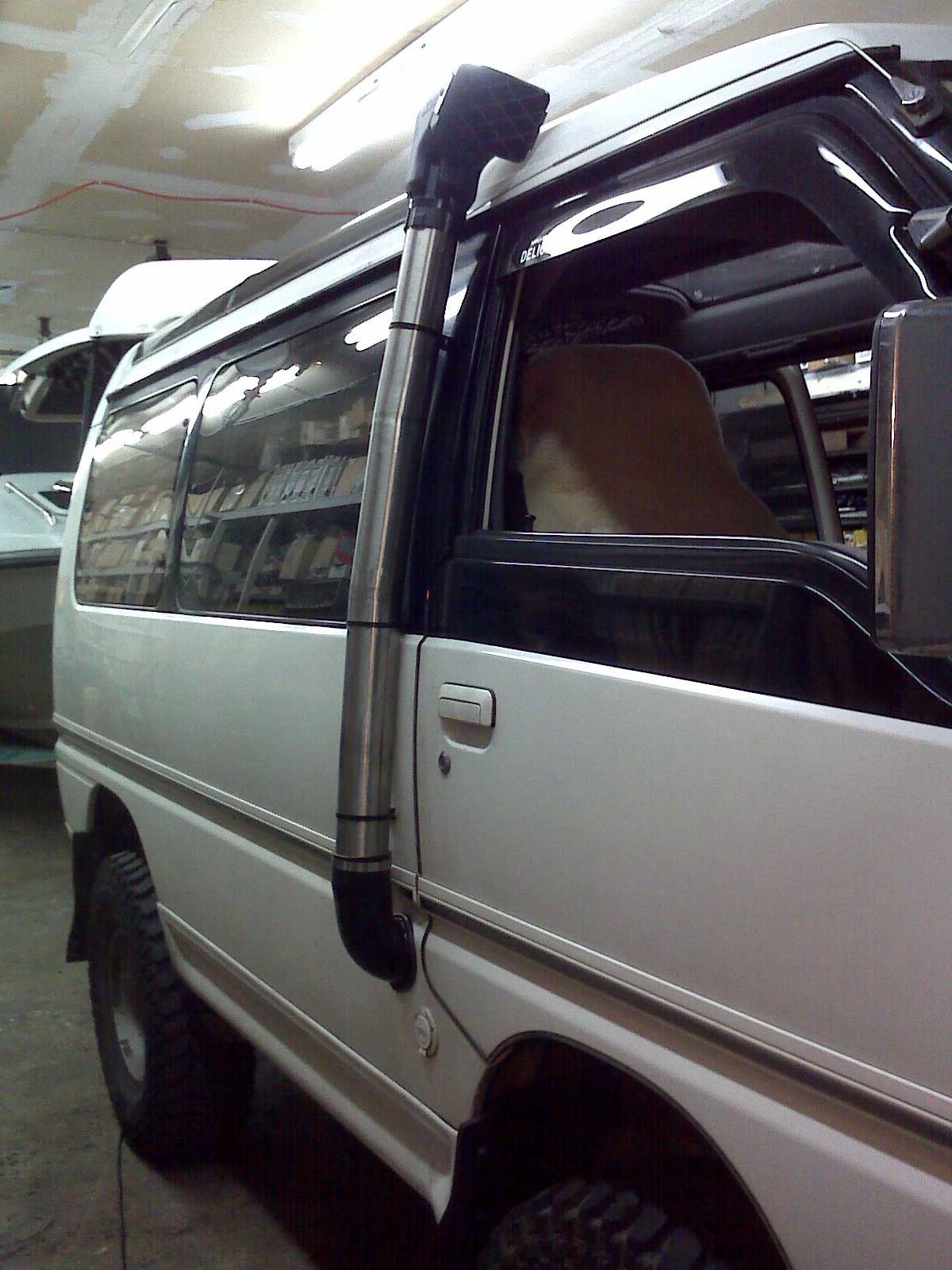

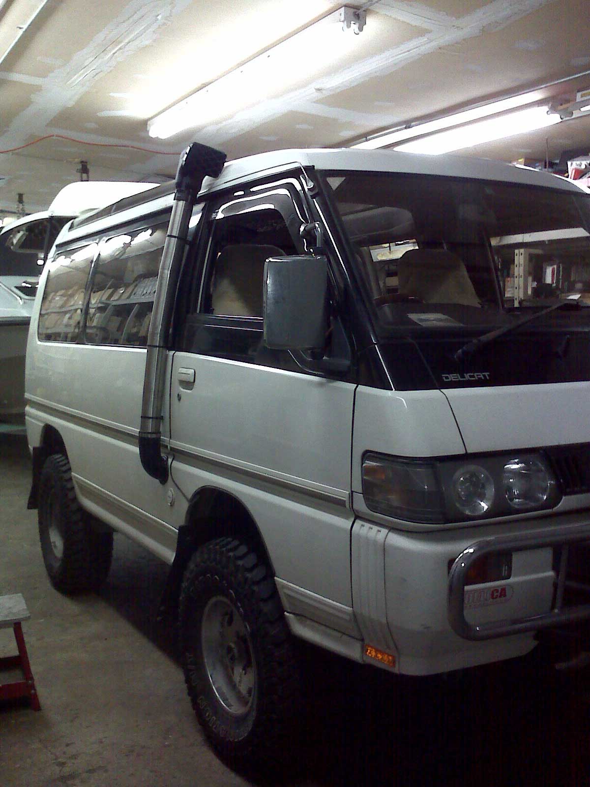

And the end result. I might replace the black hooks on the pipe with stainless ones or might just paint the whole thing black. Haven't figure it out yet, suggestions?
BTW, I just noticed a VERY nice side effect; my EGT dropped down by about 200 degrees, that's huge! It now sits just above 600 at hwy speed and same results going uphill, it doesn't climb nearly as high. Made me realize the Delica doesn't breath deep enough stock...
David
final result.jpg (141.54 KiB) Viewed 28061 times
final result 2.jpg (140.05 KiB) Viewed 28097 times
