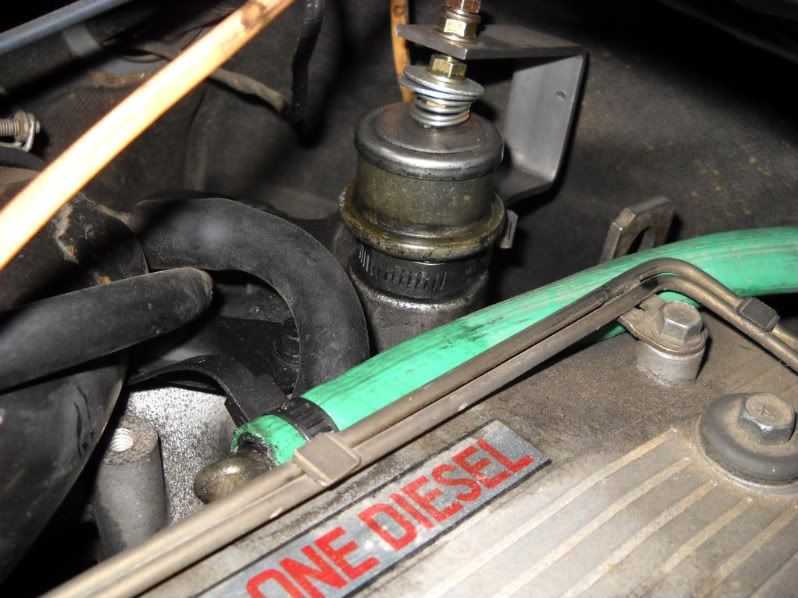

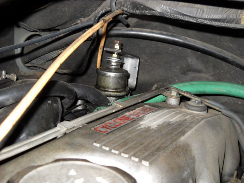

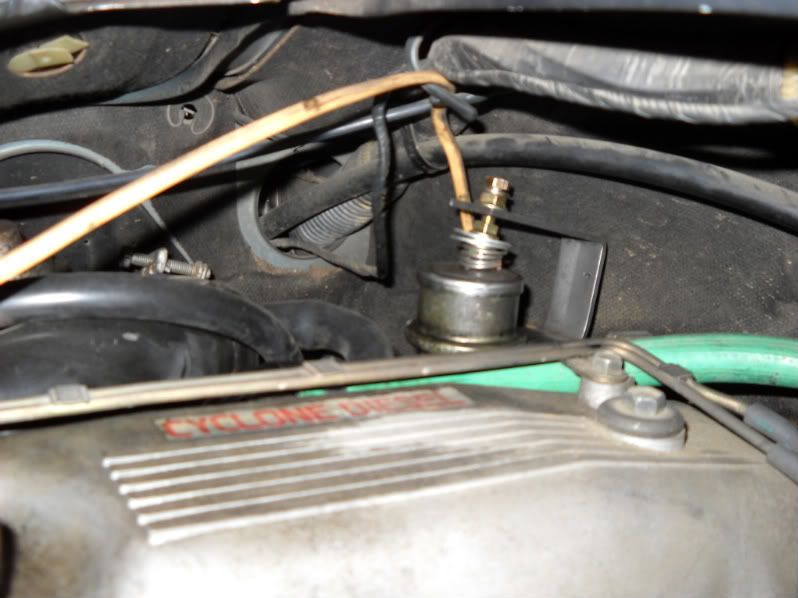

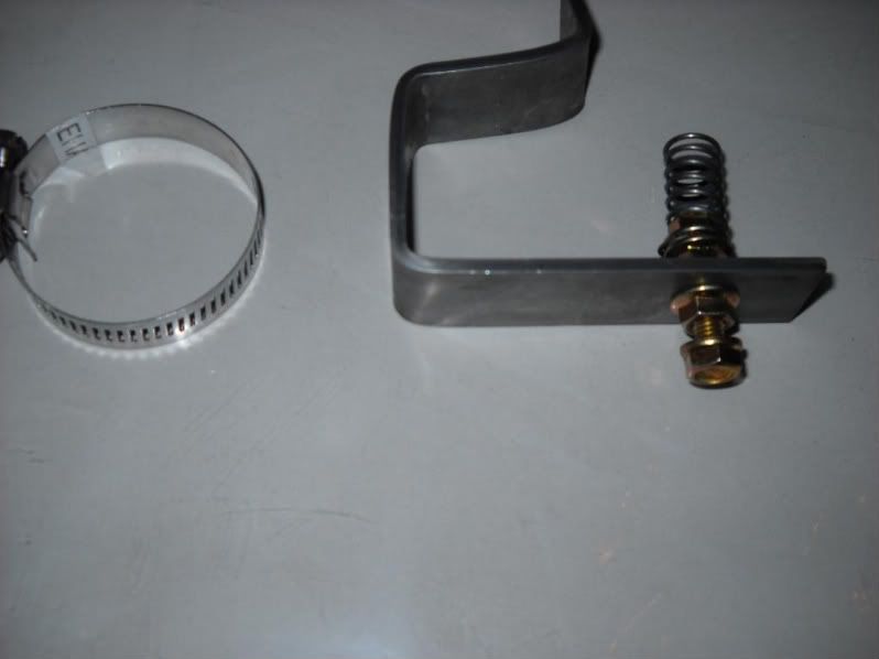

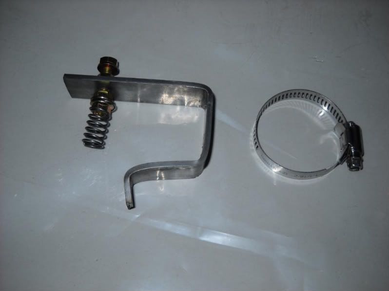

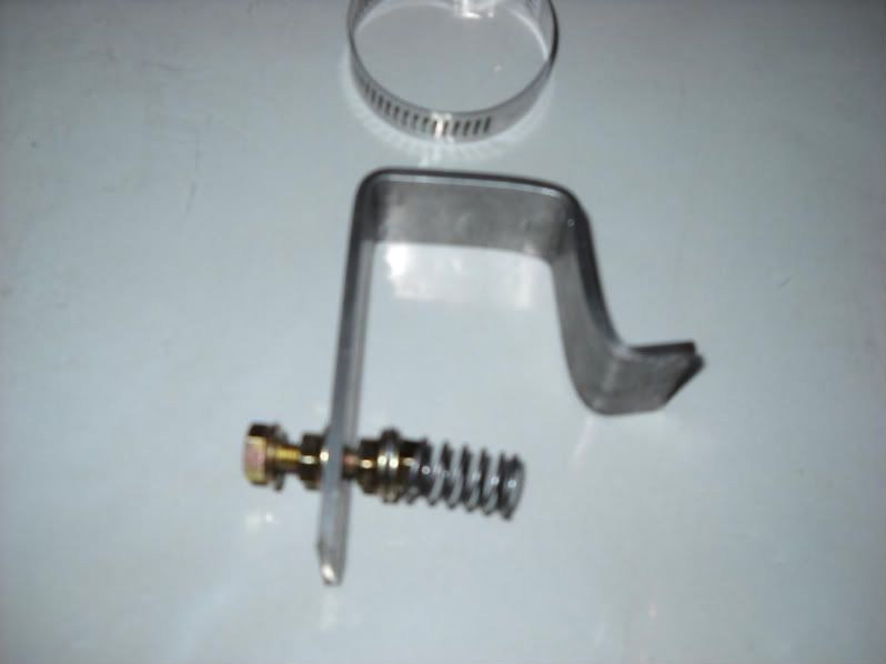

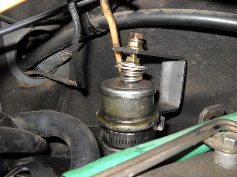

New info on my system.I made a bracket to go on my pop off valve with an adjustable spring.My max boost now is 23psi.Can feel the water injection turn on much more noticeably.Injection turns on at 20psi.Egt is lower,more air volume lean out mixture,running cooler?It is at about 870F on the 232 on ramp going east bound wot.
Hey Mephisto any idea why more boost makes me run cooler?
Thanks Shaun

Shaun:
Do you have any pictures of the bracket you made for the "Pop Valve". This sounds like a cheap way to get extra boost without blocking the valve totally. 23 # is a lot of boost.

Ya,I'll post a picture.Its question mark shaped & hose clamped to the bottom of the pop off valve.I'm using the shops scan tool to post,home computor is out for repair.

Post by shaun »
Pictures of pop off vavle spring bracket.Pops off at about 25psi.
