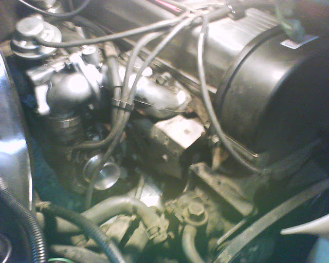

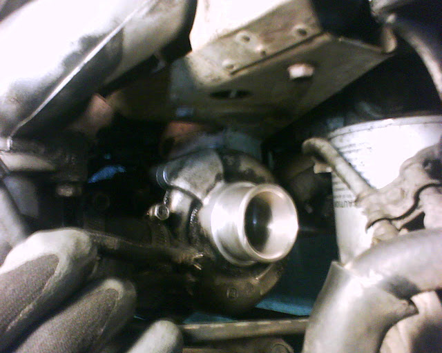

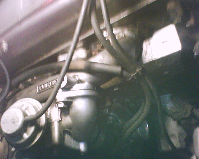

Re: burning smell and oil on ground
thatchrisguy wrote:Do u guys know where i can find a photo of a turbocharger? I've been looking on google with little success...
It turns out that I had these in my celphone, they are not the best but you might find them useful as to how the turbo looks like on the engine:
