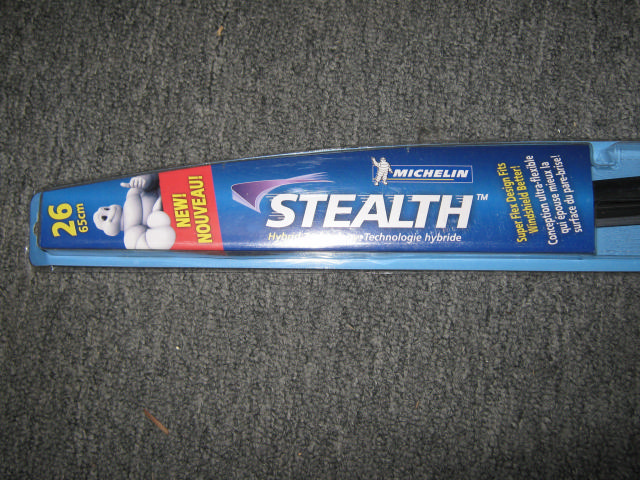

- Rising Sun Auto Import
- Posts: 1366
Re: L400 windshield wiper adapters..solved!
This is exactly what we have done. Very simple ( See pic below for Costco product ).psilosin wrote:I just bought standard type wipers from WalMart and removed the rubber wiper strip from the arm and tossed the arm (after middle fingering it of course for it being such a waste). Then just swap the new rubber for the old rubber on the original L400 wiper arms. 2 minutes start to finish. No fuss no muss. No streaks no smears just funtimes like a hippo splashing in a pond.
Using the rubber with steel shim from new 26" blade assy is the key.
Steven
