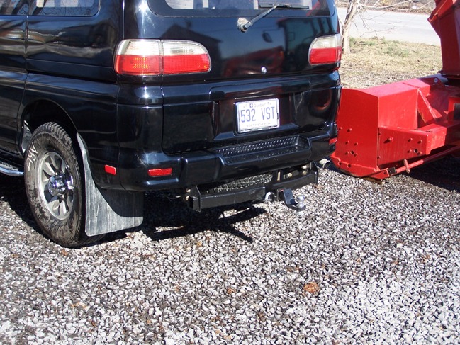

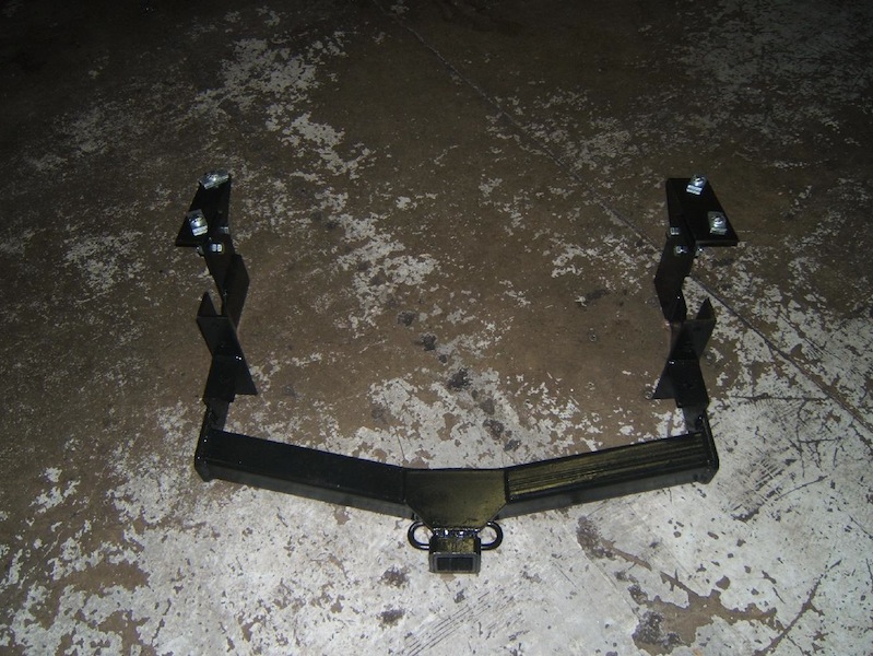

I just installed a hitch on my L400. I took and old hitch originally use on a GMC pick-up truck, modified it and fit it to my L400 with some bolts and brakets. Look nice and make the van much more usefull by being able to use a trailler!

:-D Nice!

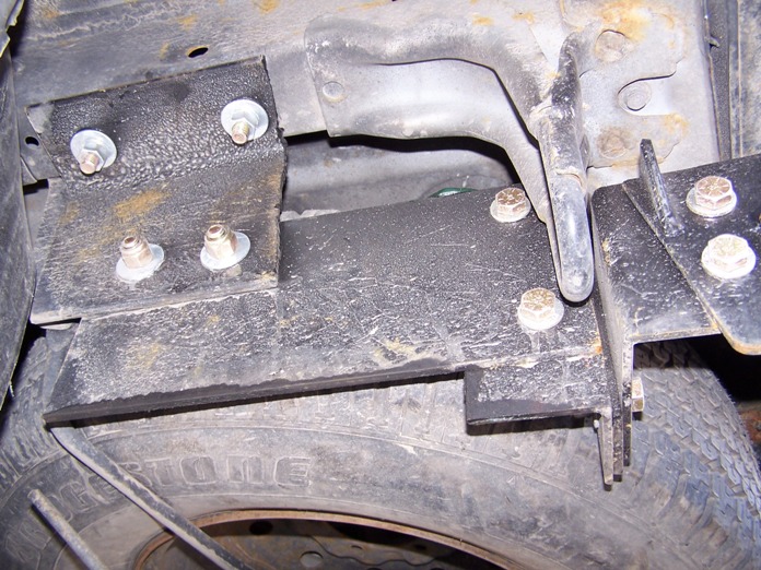

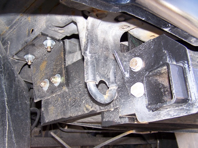

Looks Great. Could you post some pics of how you mounted it? Thanks

Looks great! I like your idea and also would like a view from under you van to see your brackets and bolts. :-)

Here's a picture of under the van. I cannot say that it is the most reliable mounting, but for what i'm gonna use my trailler for, I think it's enough. I use 1/4" thick metal and 1/2" grade bolt. I also attach a braket to the bumper mounting. I did'n drill any new holes on the van, I use those already there.
The big deal with all of this was to cut and drill in this 1/4" thick steel. Took me more than 3 days to install all of this!
