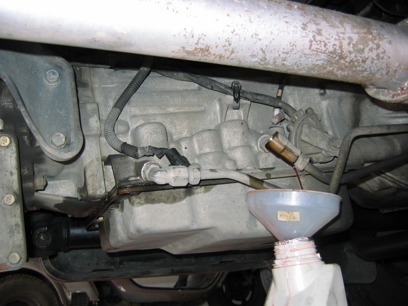

My A/T temp light came on twice while climbing to Hemlock Ski Resort recently so I had to stop for cooling down.
BTW where is the temperature sensor located?
Profister
Posts: 963
Location: North Vancouver, BC
Re: automatic tranny over heat light problem anyone?
Post by Profister »
Never mind, just found it on UK forum.
Temp Sensor Out.jpg (163.91 KiB) Viewed 12566 times
