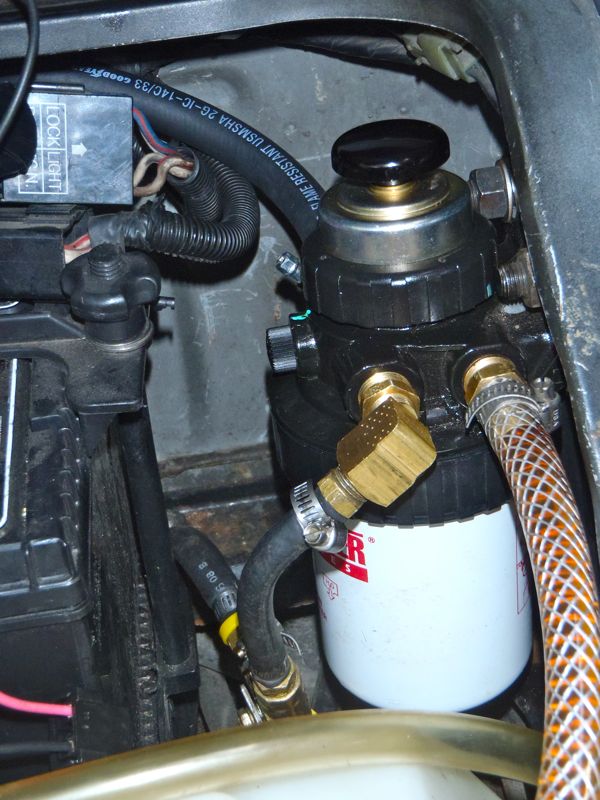

i've looped it in to one of the OUT ports of the FM100. but with a manual 3 way valve before it so i can switch it to return to tank for purging air etc. day before yesterday Turtle officially became a vegetarian! still waiting on the tank, but full install thread coming soon!
the return comes from the IP and into the filter at the left front of the photo. you can just see the three way ball valve TEEd in below. the clear hose with wvo is temporary. the hose from the tank will be proper fuel hose so i can run diesel there too if'n i want.
the hand pump for priming works like a charm!

Your set up looks right, the valve before your "t" is you return valve, same set up as mine. With this set up I often skip purging and just return direct to tank to lube my diesel... Winter is when I give it a good purge.
