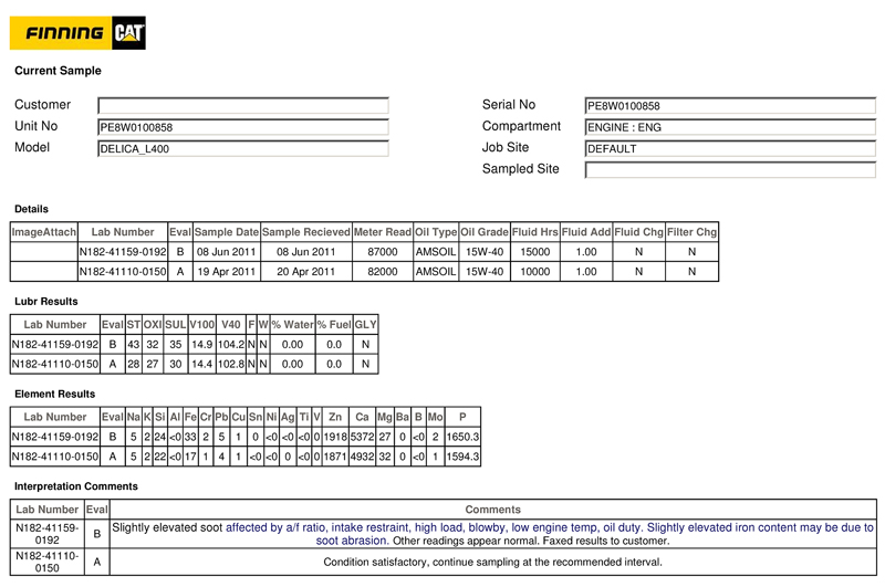

As some of you might know I have a dual bypass filtering system BMK-23 from Amsoil installed in January and using Amsoil Heavy Duty Synthetic 15W40 oil. The idea was to reduce the number of oil changes which I had to do every 2 month with the stock equipment. Being concerned about the way this advanced filtering system works in real life I decided to spend a few bucks ($25 per test) monitoring the oil degradation process until I know how often I have to change it. I have done 2 tests at 10,000 km and at 15,000 km and this is how the results look like:

It is interesting to see that the oil viscosity does not change and remains within the specs but the amount of soot goes up which makes me wonder how good the fine filter is. According to Amsoil this filter should be good for 60,000 miles.
I would like to see more reports from other fellows using bypass filters for comparison. Let's keep this thread open to share the experience.

It would also be interesting to compare to regular oil and filter changes to give you a perspective.

The logo says it all - Finning. :-)

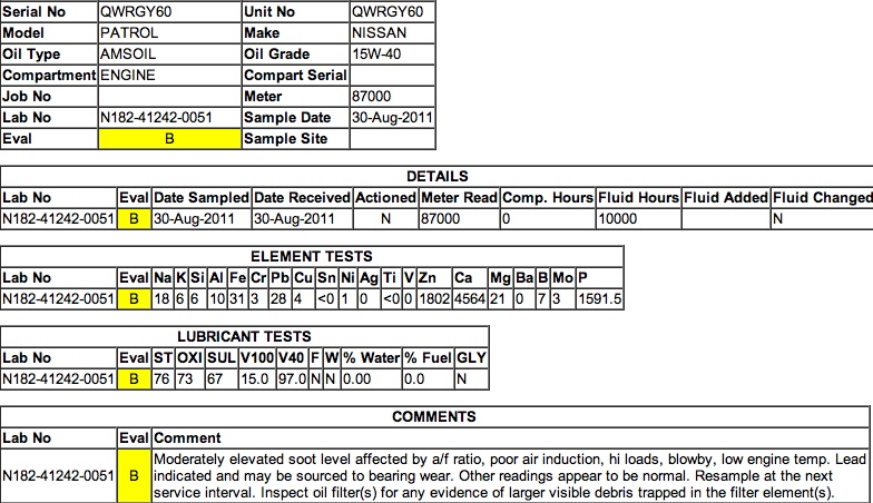

Here's my result on my 1st 10,000km with the Trabold bypass filter. Seems like pretty generic comments, only difference is you have slightly elevated sooth while I have moderately elevated sooth level. My numbers are higher in most parts, lower in some but I need to figure what they all indicate because now they are only numbers without reference...

It is interesting that both of you are seeing elevated soot levels with the bypass filters installed since soot removal is the primary item these filters claim to remove and why oil change intervals can be greatly increased. Soot is one of if not teh most damaging contaminent in diesel oil. I have been running a Jackmaster toilet paper type bypass filter in my hilux surf for the past ~2 years. I have never had an analysis done but extended my oil changes to 2-3x normal (ie 10000-15000km) thinking that was well within safety limits of teh recommended change intervals. Your results are making me a little nervous that all the glowing reviews are just a placebo effect so perhaps I will get an analysis and post results. Different vehicles but with a bypass we should be seeing reduced levels of soot in our oil/km than normally expected at a given km.

I'm running mostly on wvo so that might have an impact on my results as they often recommend to do oil change at 3000km instead of the regular 5000km if running on wvo. I've sent a copy of my results the the NorthAmerican distributor for Trabold, we'll see what they have to say. One thing that I really appreciate from them is that they still send me emails to see how my system is doing, you don't see that from large company!
I started installing back my water/meth injection system to deal with this exact issue. The water/meth is well known to keep your engine really clean so it will be interesting to see the results once it's set back up.

We do oil analysis alot on the transit buses, don't get down on only 2 readings you want to watch the trends, mainly watch aluminum, copper, lead, iron. Lots of iron usually indicates gear wear/cylinder wall. Lead/copper indicates main bearing/cam bearing wear. Aluminum can indicate two things first it is main bearing wear, second is piston skirt wear.
