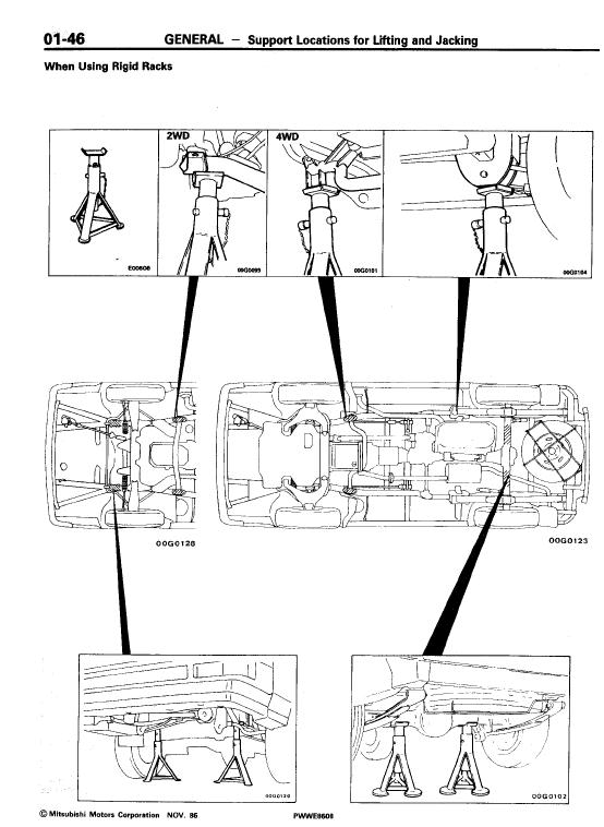

Look at the crossmember under the transmission. On each side you'll see a jack point that is about 6" long and 3x3"
It's also in the wiki, downloads and manual
- L300jack.JPG (69.16 KiB) Viewed 1687 times

I'm sorry if my observational skills aren't up to par but I still don't see it. The rear makes sense but it looks like there are only 2 points In the front for the 4x4 version.

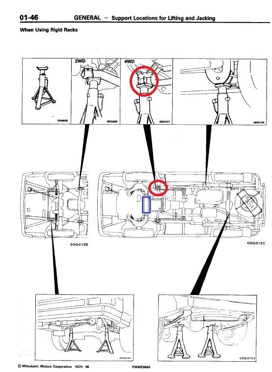

The floor jack you are using to lift the rig, you can jack in the middle of the subframe at the rear (in blue) and then put the jack stands where the red circles are on each side of the crossmember.
