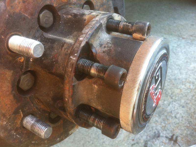

So I am having problems getting my auto hub off. It sounded as though I would need an allen key and a ratchet. Now that I have found this post http://community.webshots.com/album/359792027RPuxHZ on the UK site I'm having doubts. The problem is that I don't have all of the tools specified. Is there a work around that people have found for removing the autohub? Here is a picture of the stage I'm at...

Re: HELP!!! Stop rotors from rotating / Removing Auto Hubs
In a pinch use some big pliers, even a pipe wrench to turn the center cap off.
I wish I had a garage full of tools but alas I have just begun collecting (no wrench that's big enough). It seems that I'll have to go out and buy some more tomorrow. At least it will cost less than having it done at a shop and I'll have tools to show for it at the end.
