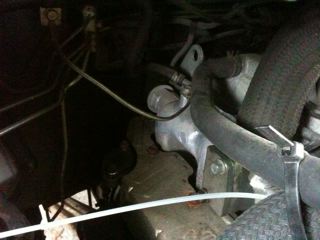

Re: Blow Off Valve (BOV/BPV or maybe Relief Valve)
Picture sucks but, if my suspicions are correct, thats the part in question, in the back, looking like an aluminum mushroom that you'd pick with a pipe wrench.
That's the relief valve that used to control or limit the pressure in a system to avoid failure/fire or something.Airgonzo wrote:Picture sucks but, if my suspicions are correct, thats the part in question, in the back, looking like an aluminum mushroom that you'd pick with a pipe wrench.
I have no idea if that is the case.
Steven
it's a fair big ol' nut and a b*stard of a spot to reach (although a chopper mechanic might have more experience...
On my rig, I could see it was blowing open (makes a hiss like a compressed air line letting go) because it blows out a bunch of fine black crap from the intake manifold all over my nice clean hood interior... My wastegate actuator was sticking at the time.

tonydca wrote:OK - quick, easy and freetest for your Pressure Relief Valve (PRV) which seems to have helped my little hissing problem and power/boost loss.
Firstly, put on some rubber gloves and an old shirt if you have them!
As mentioned earlier, the PRV is a small round spring-loaded device on the rear of the intake manifold, pointing at the driver through the fire wall. In theory, it is set to open up at around 12-14 psi to prevent engine overpressure.
When the engine is at idle or stopped, it is difficult to grip the skinny outer plunger ring of the valve and pull hard enough to open it.
But when you spin the engine up to around 2500 rpm or so (either with a friend on the throttle, or by reaching around with your right hand and tugging the throttle cable) you raise the manifold pressure to a few PSI short of the valve popping open on its own. Now a relatively gentle tug will get it to spring wide open.
When I first did this, the opening motion coupled with the outrush of 12 psi air blew a satisfying amount of evil black oily crud the consistency of lard out of the PRV and onto my hands, jacket, face, etc. in a small cloud.
Popping the valve open and letting it shut again, rotating the plunger, and repeating about a dozen times blew out less and less junk, until now it seems (relatively) clean.
More interestingly, it became slightly more difficult to open as it cleaned itself out.
I believe that 15 years worth of accumulation from crankcase breather fumes, etc. had built up around the valve innards, impairing its ability to seal properly.
It might be wishful thinking, but the van now seems to rev more freely and pull stronger at higher revs. My ears are still buzzing from hugging a revving engine for so long, so I can't tell if the hiss is gone, but it seems to be an improvement.
Time will tell...
