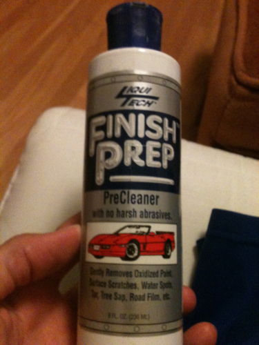

This is the best product I have ever used. I started using it before I moved to Vancouver and ran out while living out there. It was one of the first things I bought when I got back.
It's called LiquiTech Finish Prep. It's a multiple step prep and wax, but the prep is what makes all the difference. I tried many different products while living in BC and NOTHING came close. It will take ANYTHING off with surprisingly little effort.
You can't buy it in stores but here is where you can get it from...
Doug's Ultra Shine
519-351-0404
Or you could try getting it right from the source (maybe, not sure)
LiquiTech corporation
P.O Box 1520
Beaver, WV 25813
1-800-637-4527
You won't be disappointed, this stuff is unbelievable.
EDIT: Oh, and it has a money back guarantee... and you can order right from the website (didn't know that) http://www.finishfirstpolish.com/products/
