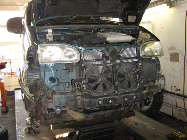

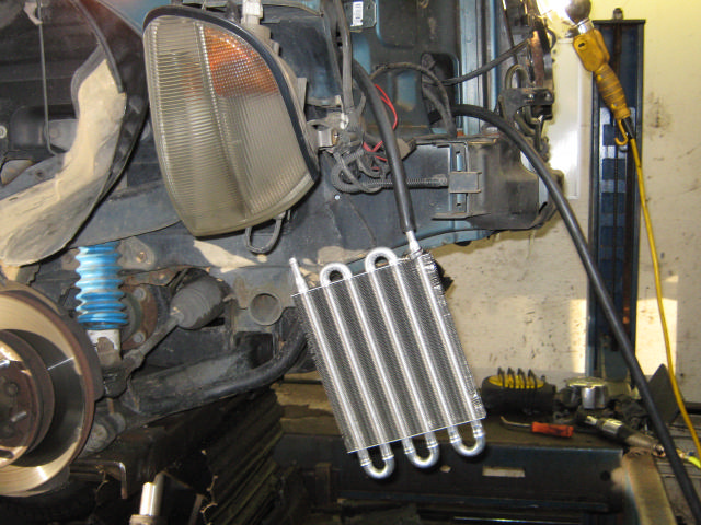

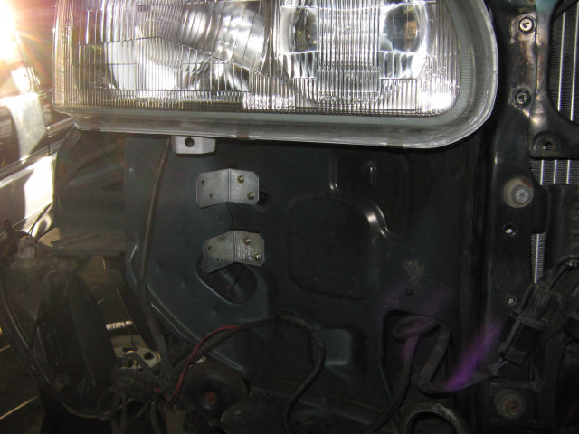

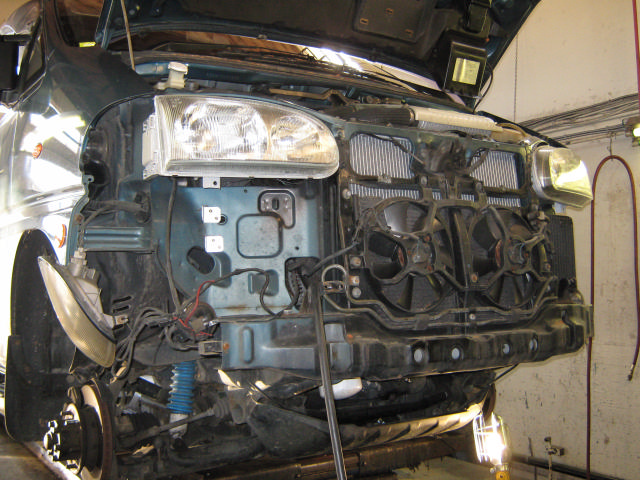

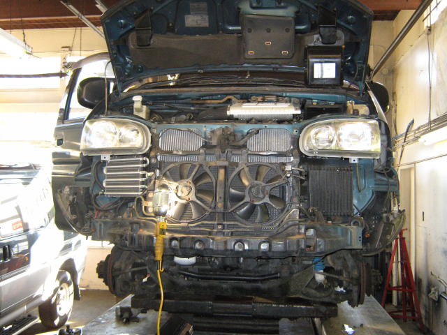

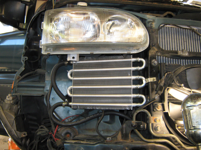

Installed a second transmission oil cooler for the cutomer who drive a lot in mountain area.
It takes appro. 5 hours to install.
Hoping to be helpful for L400 owners who consider installation.

Thumbs up. Looks like it fits there nicely.
