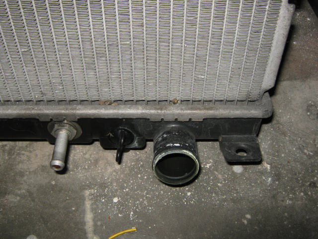

Where is coolant drain plug located?

Spadelica wrote:Where is coolant drain plug located?
Sean
Just near lower radiator hose.
You need to take off cover to reach.

Thanks, it is the first one I removed, then separator plug and radiator cap. I was following the manual saying forth step is remove drain plug from cyclinder block to drain engine coolant, it is the one i still looking for.
