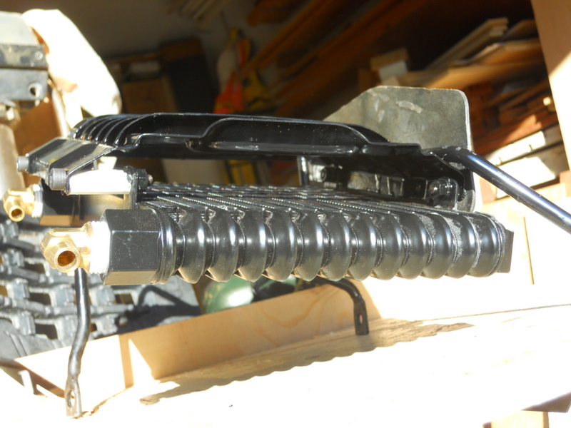

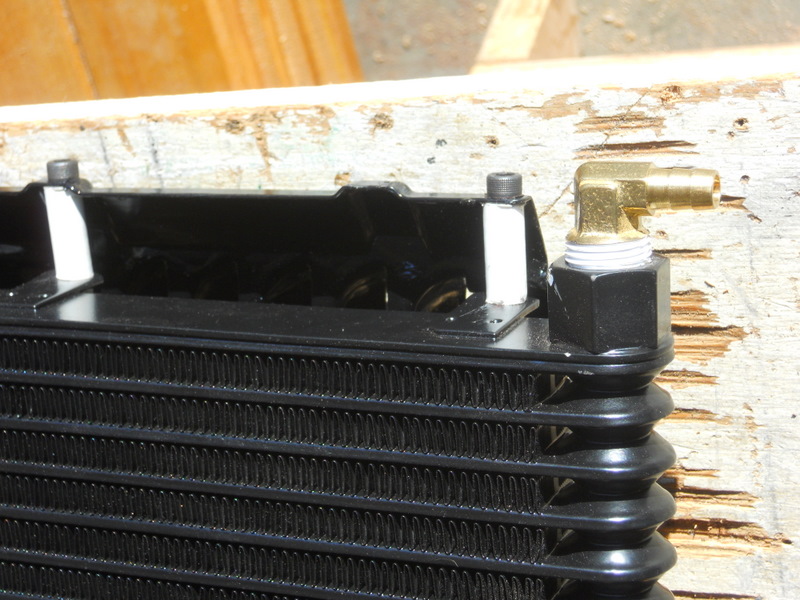

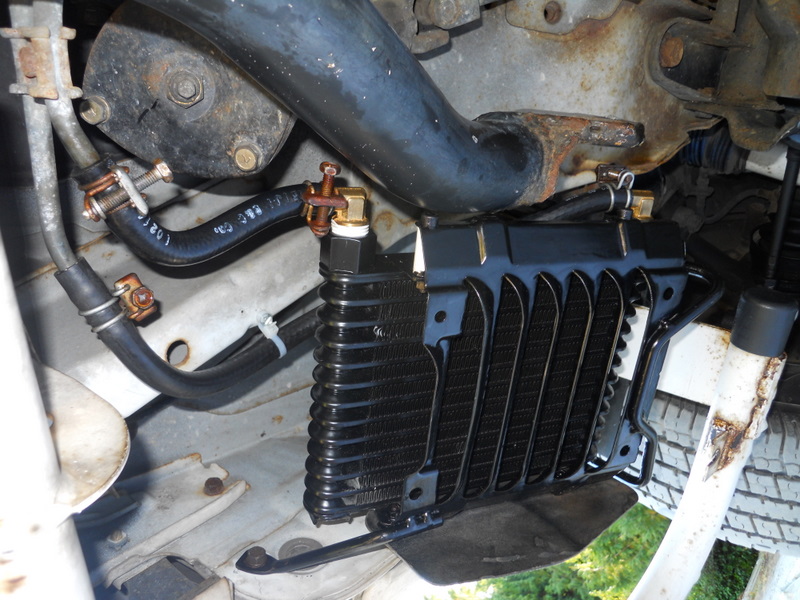

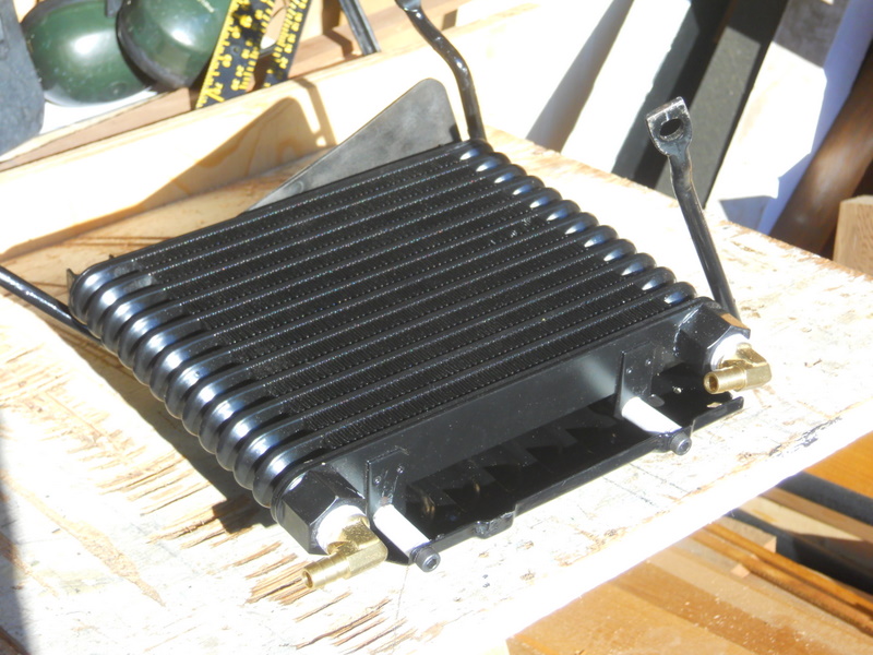

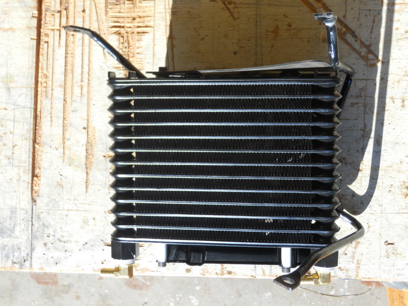

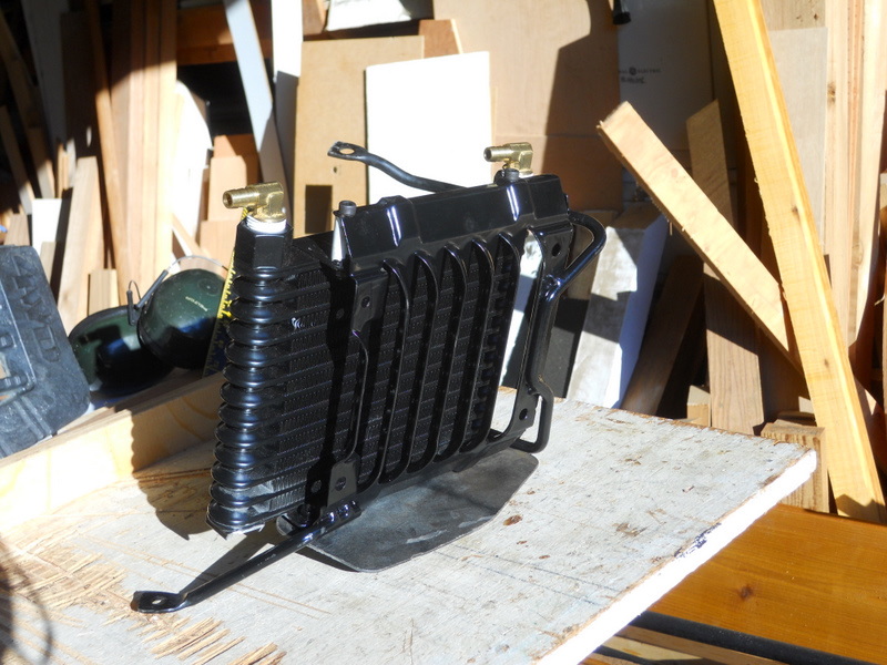

About 2 weeks ago my transmission oil cooler developed a corrosion hole and spewed fluid all over. I could not find a direct replacement and did not want to chance a used one. Here is a link to what I found on eBay (http://www.ebay.ca/itm/330593242790?ssP ... 1439.l2649) which was almost a 100% match of the original and just required some creative mounting (see attached pictures).

- Final Installation

Were you able to raise it up further as well when you were mounting it?

Re: Transmission (tranny) Oil Cooler Replacement
Due to the changed mounting for the new cooler, it now sits about 1 inch higher above the 'shield' which should protect it a little more from small rocks. If one wanted the back end could be tilted up further as there is quite a bit of space on the back side (there is nothing on the front). Not sure you would want to do that as it would affect cooling. For serious off-roading one would want to relocate it completely.
