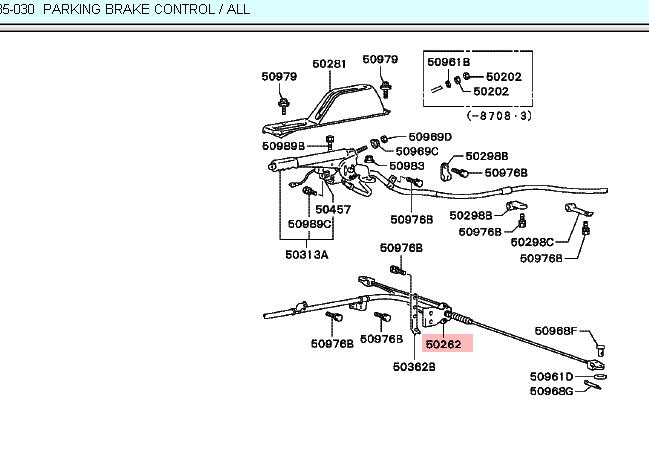

Re: Parking Brake Cable Replacement - what part#?
mb256987 or mb256802
