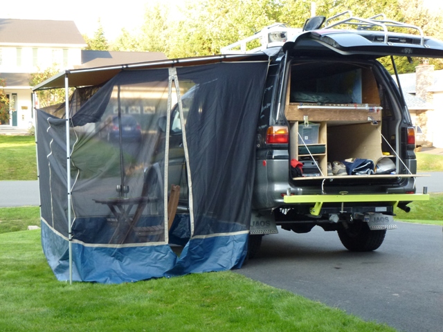

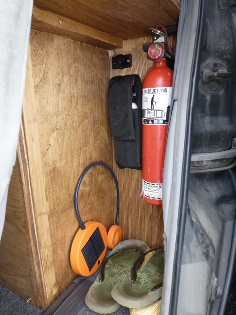

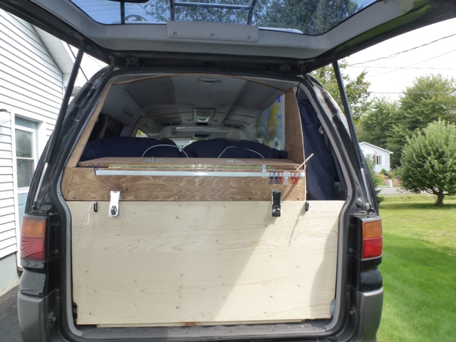

The bed measures 122cm x 165cm with storage underneath. The small vertical cabinet supports two wooden chairs and a table (IKEA) and the mosquito tent and the solar equipment. The solar panel is mounted on the roof rack. The underbed storage is lockable to increase security while the headboard is hinged to permit visibility while driving but when parked provides protection against snoopers AND has two fans and two LED lamps (on the solar electric system) for living comfort.

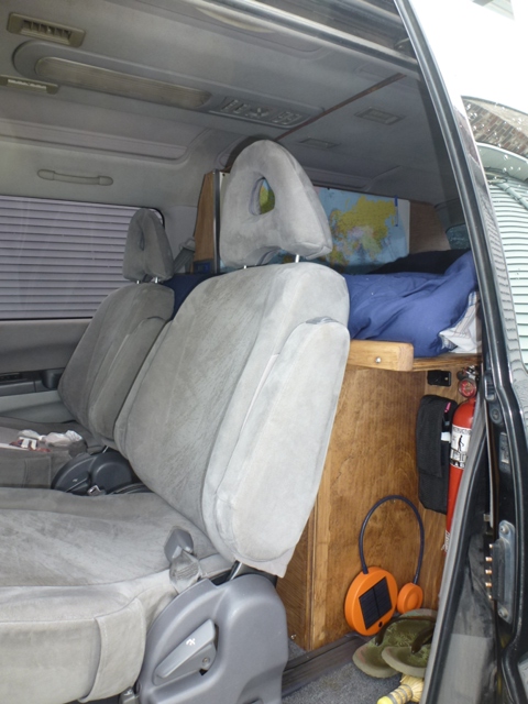

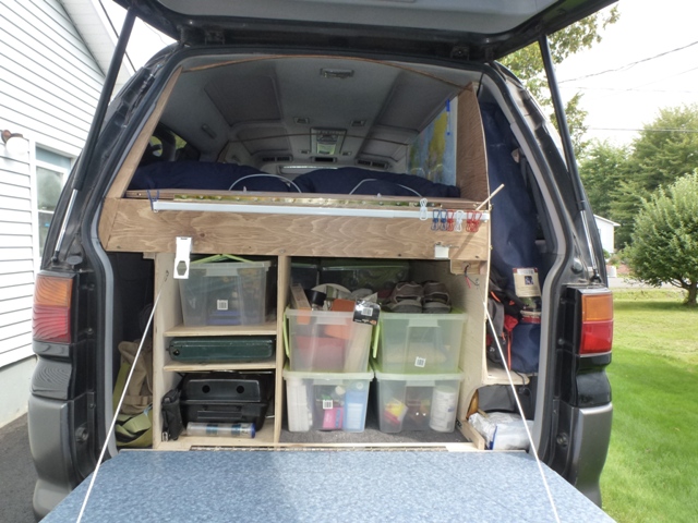

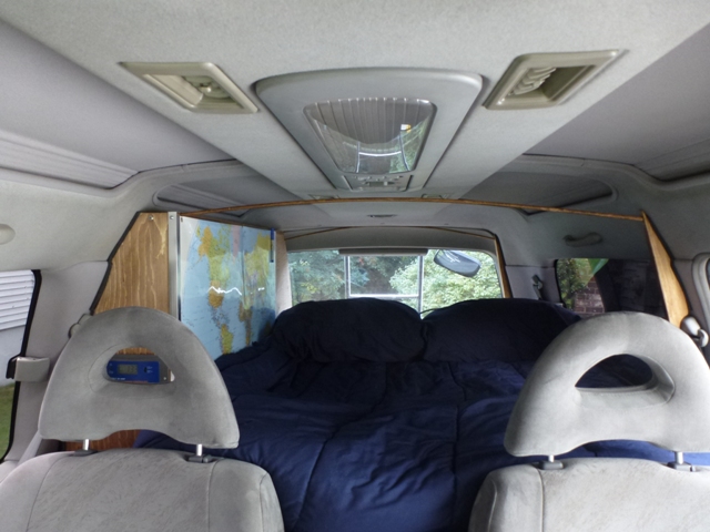

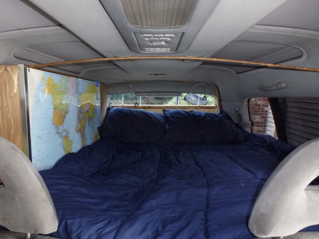

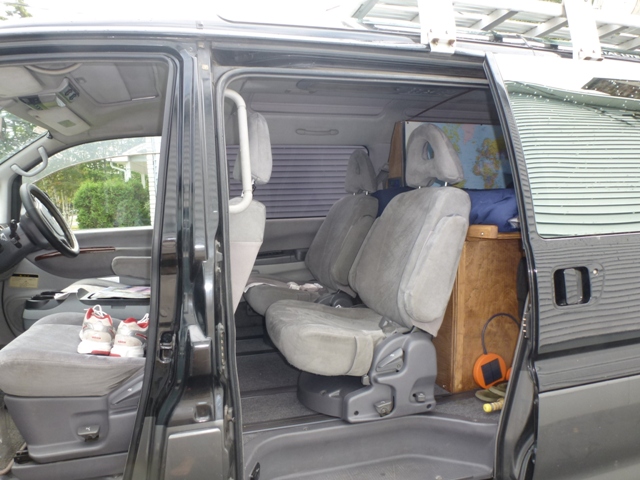

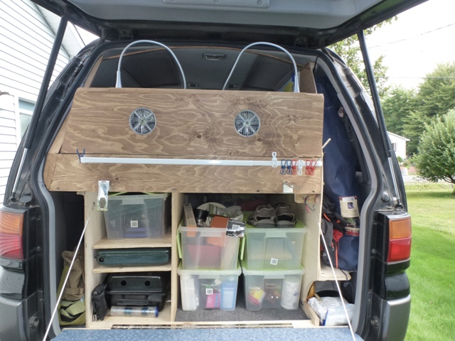

more photos
- P1010670.JPG (186.16 KiB) Viewed 6243 times
- P1010672.JPG (183.02 KiB) Viewed 6243 times
- P1010675.JPG (190.07 KiB) Viewed 6243 times
- P1010640.JPG (204.08 KiB) Viewed 6243 times
- P1010638.JPG (178.55 KiB) Viewed 6243 times

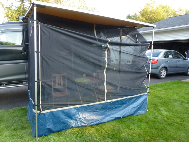

- ARB Awning and mosquito net
- P1010637.JPG (180.45 KiB) Viewed 6243 times
- headboard up for sleeping
- 8.JPG (177.03 KiB) Viewed 6243 times

Wow, quite the set up ~ looks pretty comfortable. I see you have a map of the world in the cabin, is this a clue to your future plans?
P.S.: Time to update your profile, looks like you got a vehicle now... smiles.

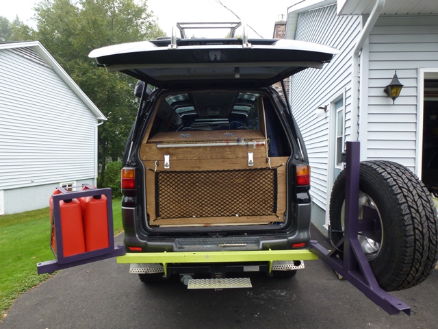

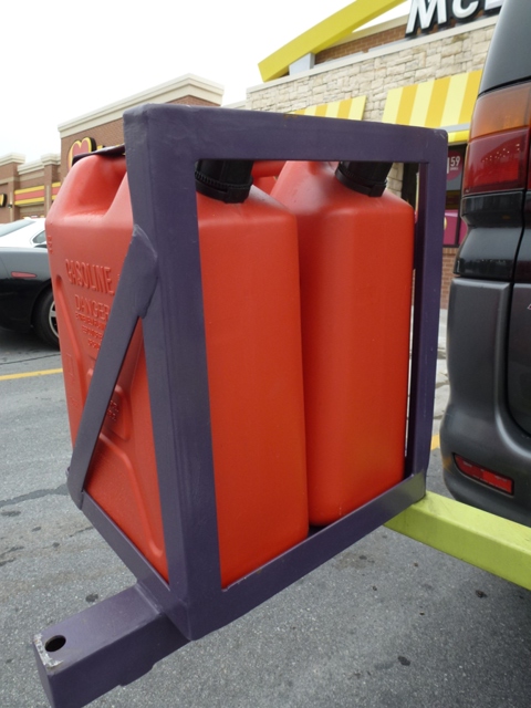

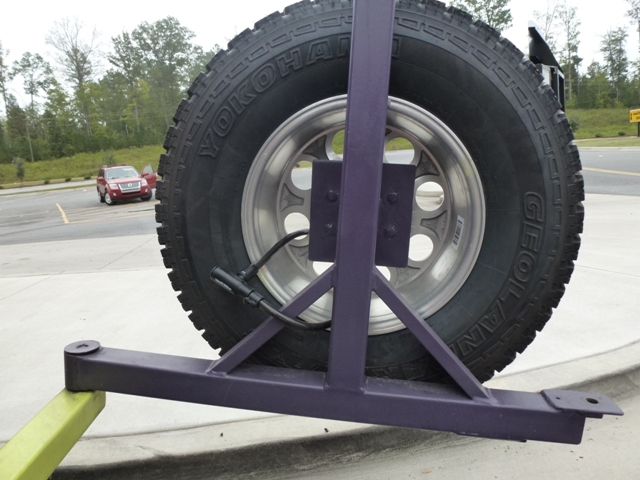

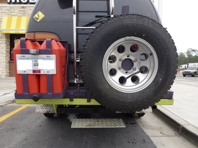

Could you post more pics of your swing out tire/gas bumper?
Its the first one I have seen in Canada!

Great use of space. Nice work.

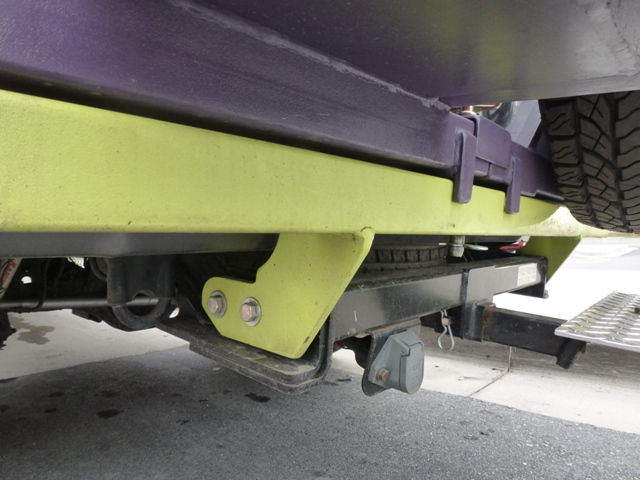

Hey everyone, thanks for the compliments. We are happy with the arrangements so far and have mostly been able to save camping fees here in the states by 'overnight parking' at various locations. So far so good with not one visit from the 'friendly' troopers...
The rims are from Japan and came with the delica. I tried to search online for them to see if I could source a rim for my spare tire carrier but I turned up nothing. They are Japanese rims and only available in Japan (I think) tho I see a few brits have them too. They are 16"x8" with 265/75R16 on them.

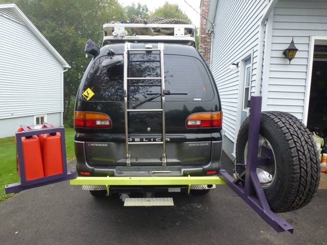

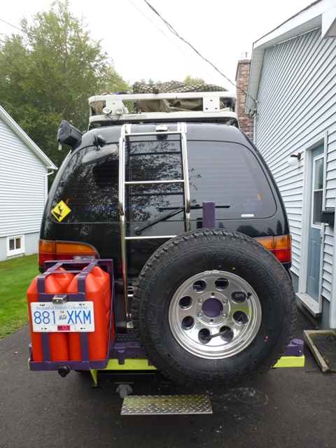

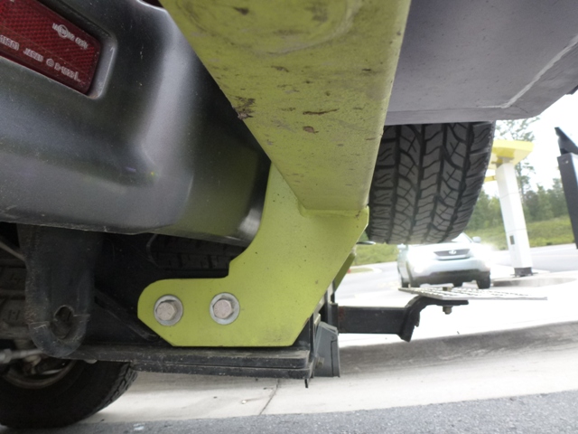

REAR TIRE CARRIER: this is a simple mod I had done up thanks to my Bro in law(and some of his staff) who works at a metal fabrication facility. We pulled it off in a week so it is not as 'clean' as I would like and my dreams of fancy stuff decidedly turned to 'what can you do fast'.
Note that Jesse and his pals have fabbed up a spare tire carrier for the L300 (you can search this site) and when you keep it simple the ideas become similar.

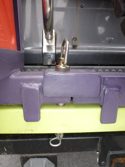

I have had the fortune that my delica came with a tow hitch and this allows me to 'bolt on' to it with my spare tire carrier. Jerrycans from canadian tire are harder to deal with than the Spectre or army surplus cans - but considerably cheaper. Couldn'd source our a fancy closing 'gate latch' for the carrier in Fredericton so am using a 6" trailer pin that we can lock with a padlock. This will give us extra protection of the rear of the van and all our storage....hopefully we won't have any break-ins!

I like the headboard with built in cooling fans. 'Cool' idea.
