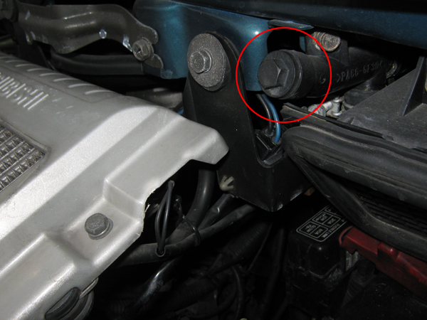

Also check the bleed valve in the engine bay. It's above the injection pump along the firewall. It looks like a black hose with a nylon nut screwed in. turn the engine on, let it idle, put the heat to full blast with the blower at full and the undo the nut. coolant should start to flow out. when it does, close it and then check to see if it still leaks inside.

Re: coolant leak
X2.jfarsang wrote:your heater core/blower motor is there behind the glove box.
take the glove box out and check the hose going into the heater core.
Probably loose clamp connection or cracked hose.
When it comes to bleeding, warm up the van up to the operating temperature, and open the nut (circled in red) until coolant comes out. The nut is made of plastic, so do not over-torque it when you tighten it. Be careful of the hot coolant as well.
Good luck.

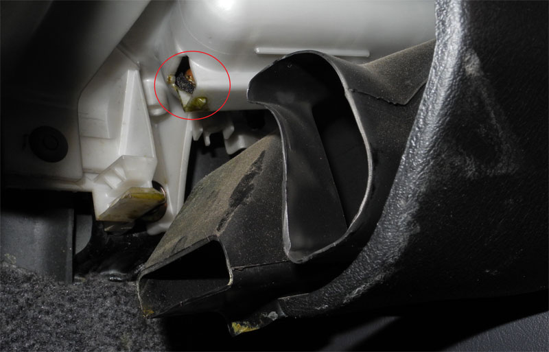

Re: coolant leak
I just fund the leak. I am not mechanically oriented and have no clue what is this plastic container and how to fix the dripping.jfarsang wrote:your heater core/blower motor is there behind the glove box.
- that is where the leak come from
- coolant-leak.jpg (61.97 KiB) Viewed 7011 times

Re: coolant leak
Hi Claude,
I have a similar problem with mine; the smell of coolant inside the cab when the system is on. No wet carpets and no loss of coolant. I'm not quite sure what bleeding the system via the engine bay has to do with this type of leaking??? But did it work for your leak?

Re: coolant leak
Heater core is just a really small radiator that engine coolant goes through to heat the inside....
Generally they get a small pin hole and when the system is hot it has around 10psi pressure pushing out fine mist of antifreeze gas....adds moisture so windows do not defrost well and the cab smells sweet...
Next they develop drips (takes a big drip use up fluid...sometimes the blow when they fail.
Basically you need to drain system, remove the heater core (replace or radiator shop can rebuild or custom one (my Jeep need a custom unit cost me $300 cash, my F350 new was $21.00)), replace, fill system, and bleed air.
Any radiator shop can fix..not sure if the L400 shares heater cores with another model (would not surprise me).
