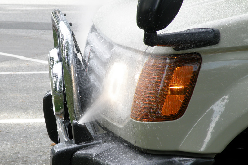

Washers should be activated by button when headlights are on.
They worked fine on my first Pajero and on second too untill that meet up
Very disappointed
Very disappointed
- my first Pajero.jpg (169.73 KiB) Viewed 6253 times
Re: Headlight Sprayers stay on
maybe the contact inside the switch (stalk)
nice spray shot ! Love 'em when they are working.
