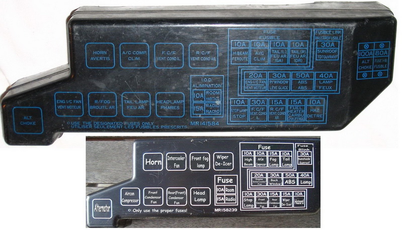

Hi Madmazda, check out the fuse box diagram regarding the fuel heater. (the 15 amp in the bottom corner)
I know I replaced the alternator and that may be why she starts easier but I think that fuel heater fuse is there for something. Can anyone enlighten me as to what this does exactly?

Interesting! Perhaps the "winter package" delica comes with some sort of fuel pre-heater? What exactly does it heat? Anyone???? Checking this fuse should be probably be part of any cold-weather-start-problem-degremlinifaction program.

Carp wrote:Hi Madmazda, check out the fuse box diagram regarding the fuel heater. (the 15 amp in the bottom corner)
There sem to be a lot of differences between the two. Anyone know why? Is it different years, translations, etc?

The 15A fuse is for the front windshield wiper defroster (defrost strips) on the Super Exceed/Royal Exceed's.
I have never seen, nor heard of a factory installed fuel filter heater on the L400's. I've searched high and low and cannot find a single reference point.

Its stuff like this that makes me glad I'm a carpenter. I will attribute the easier starts to the new alternator and new battery. As for the "fuel heater" well it needed a new fuse and it got one. Jesse, thanks for the info.

Interesting that the legend on the cover is in english and french. I wonder where that unit was originally sold?
Be interesting to cross-reference the Mitsu part number conveniently stamped on the cover and see what exact model/spec. it comes from.

My shop manual for the l400 shows an electric element in the fuel filter housing (same as vixentd described) as an option on the l400 for fuel heater. Since it was an option, there are probably some out there. If you have one, there should be 4 wires going to your fuel filter. 2 for water sensor and 2 for element. I also don't think it would affect your cold start, but it may also power something else. I have seen one l400 with an extra element in the intake manifold, and it seemed to work with the glowplug circuit. I couldn't find any reference to this in the shop manual, so I'm thinking it may have been an aftermarket add on, but the install was extremely clean. Looked factory, but no fuel heater on it. Do you have any extra wires going to your fuel filter? Or maybe some wires going to an element threaded into your intake manifold? The intake heater would definitely help cold starts.

jfarsang wrote:The 15A fuse is for the front windshield wiper defroster (defrost strips) on the Super Exceed/Royal Exceed's.
And Chamonix's Mr.P pointed out. 8-)
Wait....I have a front windshield wiper defroster?? How does it turn on?
