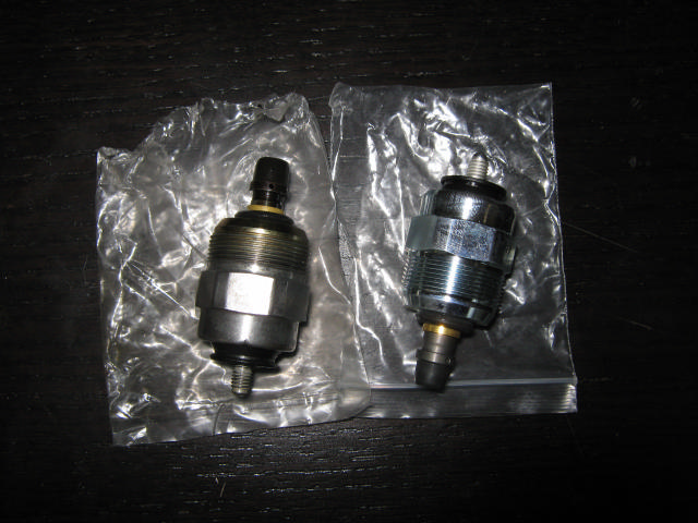

Could be.jcolvin wrote:Brainstorming other things that could be causing cold start issues, could this be a fuel cutoff solenoid problem? If the solenoid is sticking or functioning intermittently this could cause exactly these hard-start problems, couldn't it?????
Steven
- IP fuel cut solenoid.JPG (115.16 KiB) Viewed 6129 times

of course it could be. could be many things. other than posting pictures (you should be posting it in the FAQ section instead), you're not doing the OP any help Mr. Advertiser. If you don't have anything to contribute, don't postRising Sun Auto Import wrote:Could be.

The simple question asked by the OP was could it cause hard starting if faulty. RSI gave a simple answer which is correct, and gave a picture of what it looks like which may be helpful to the OP if he is not sure what to look for. It would be nice if Jesse would quit with the personal attacks. I'm tired of it, and I think others are to. If you disagree with Stevens advice, say so, but please keep your personal junk out of it.jfarsang wrote:of course it could be. could be many things. other than posting pictures (you should be posting it in the FAQ section instead), you're not doing the OP any help Mr. Advertiser. If you don't have anything to contribute, don't postRising Sun Auto Import wrote:Could be.![]()

Well, I am sick and tired of Mr. Advertiser aka Rising Sun Imports posting junk (mostly with pictures). What kind of answer was that? Yes, it could be. How valuable this answer is? How this part in question looks like is irrelevant. Jfarsang always provides technical solutions or troubleshooting steps unlike RSI who jumps into each post with images of parts he sells de-railing literally every single post. So what? The Administration pretends that nothing is wrong and the mess continues to build up. This is not jfarsang who starts the fight but rather RSI's technical ignorance plus agressive and sneaky marketing tactics muliplied by the administrative blessing that sparks and fuels this conflict.

With regards to pictures, delica.ca has a FAQ and area where pictures/part numbers and manuals are posted. Posting an individual image in a thread like this will not get to 99% of the members down the road as this thread will be buried. It does garner the attention RSI is getting. He's your top poster.mac_stang wrote:IF YOU DON'T LIKE IT, DON'T READ IT!!

I like pictures
related to the post or not, for us less mechanically inclined and out of an area close to a JDM parts supplier It's great to see various parts labelled . When I'm futsing about under the hood and moving stuff to get at that rattling wrench the last mechanic left in there, it's nice to have a bit of an idea what the bits are.
