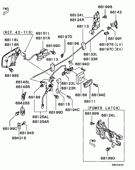

It seems one of these is not working properly due to fatigue.djelica wrote:Hard to believe it froze shut in the half hour between working just fine and not being able to open it, but thanks Jesse for your thoughts.
Not so cold here either (-3 C) and worked it pretty good from inside and out (2 of us). If it was frozen I think we would have gotten somewhere or at least heard something like ice cracking (you know the sound when it's starting to let go).
It seems like the rear portion is not letting go. I took the panel off and had some help from an old locksmith I know to check the locks and such. As it is the locking mechanisms are working (key in door, electronic and child safety). You can watch the mechanism move to allow the handle to then move the links and everything seems to be linked and pulling on something (hard to see what is going on at the rear portion).
I am wondering if the little electric motor that pulls the rear portion of the door closed when you don't slam it hard enough has decided to not work. And if it wasn't working would it still hold the door locked. Looking at the l400 fuse translation link and didn't see anything labeled "power locks" or such.
Again any help appreciated.
dj
1. 68116 in the diagram ( sliding door outside handle )
2. 68101 ( sliding door lock actuator )
3. 68125 ( door lock link assy )
Try again with patience to see which one is getting faulty.
We have them in stock as they are proven too weak.
Steven

Re: sliding door won't unlock
Hi Steven,
Thanks for your reply and help on the phone.
I am starting to think that it must be the rear door actuator motor that won't release.
Still looking for any input, however.
cheers, dj
