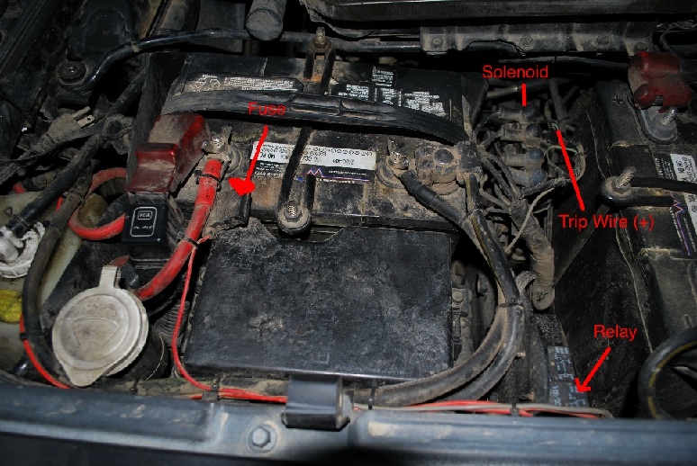

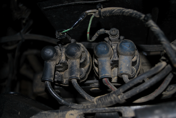

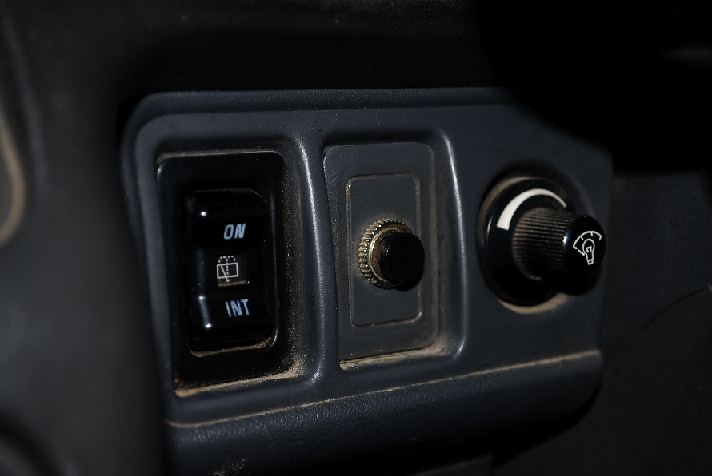

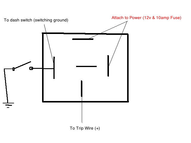

first install the glow plugs (clean all connections and buss bar etc)
install a switch push button type momentary single pole in the dash, connect on side to ground and the other to the relay as shown in the sketchy diagram
The output of the relay gets spliced (cut the wire shielding, splice, solder and re tape) to the light green wire on the vehicles glow plug solenoid. (the one with the black plastic connection)
Mount the relay somewhere under the hood, wire up according to diagram, attaching power last (after you've double check all other connections)
make sure the inline fuse is installed close to the the positive terminal.
when all is installed and working correctly, you will hear the solenoid "snap" when you hit the button and get 12volts at the bus bar
Also if your solenoid is not functioning then you can replace it at LORDCO for $23 . part #S5049
hopefully this all make sense and excuse the dirty pics of under the hood!!! needs a clean I know
also if you have any question feel free
