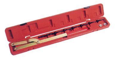

The starter trick is great for loosening the bolt...but thats only half the battle....be aware that you will be in a similar situation when you come to tighten the bolt again if you have auto trans (engine will simply turn while trying to tighten bolt). I tried the strap method you mentioned for tightening and it was a fail on every attemp.
To tighten back up you will need a two pin universal pulley holder, make your own tool or as was suggested to me...two bolts and a crowbar (worked but was tricky to keep in place) so you may as well get one sooner than later and can also use it for loosening if the starter trick makes you nervous.

And for tightening the new pulley back up, I wasn't super confident in the job I did in holding the pulley in place with two bolts and a crowbar so I dropped the $17 on ebay for a universal pulley holder. Worked awesome and I should be able to use it on my Hilux when the time comes.
universal 2pin pulley holder
