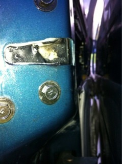

I feel like this latch is the culprit... Have let it sit with Liquid wrench to no avail...

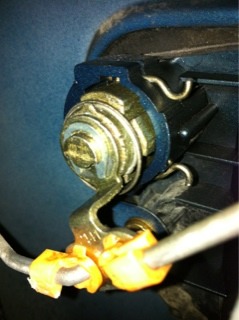

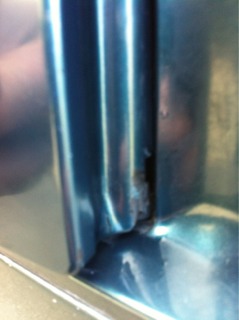

Other possibilities...

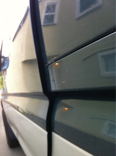

Here is how far the door will shut...

Note, if it is a power sliding close like my royal, it helps to lightly sand and polish the closing contacts at the other side of the door. These trigger the power closing mechanism, but they need good contact to do so. They have likely also been responsible for my door staying locked shut!
May not be the cause in your case, but was in mine.
