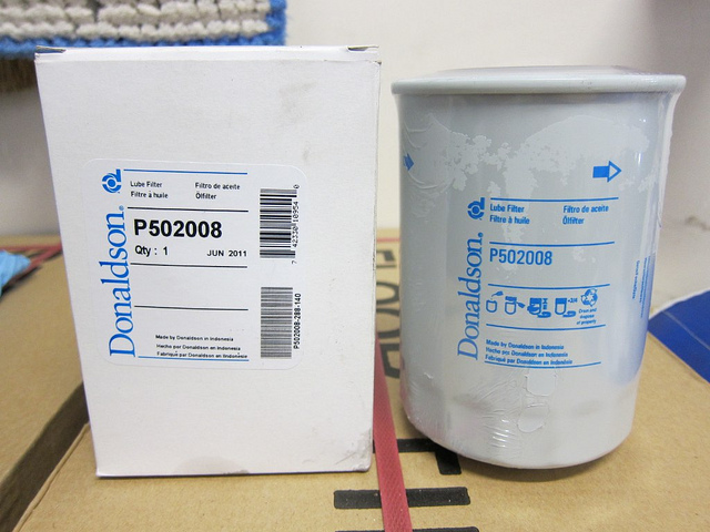

Length is listed as 5.90 inches (149.86mm) which seems longer anyway, but the picture on the Donaldson website is of a shorty filter. Thread is M26 x 1.5
Here is a picture I borrowed off another thread:
Here is the application listed for filter P557382:
Refrigeration Unit THERMO KING
SBIII
1 SE2.2
Length 6.92 inches (175.77mm) M26 x 1.5
And for the P551341 there are about 115 applications that seem to center around the 4D56 and 4D68 engines.
Length 5.31 Inches (134.87mm) M26 x 1.5
Anyone got definate numbers and what type of vehicle you use them on? Experience with them? Tell us about it. I almost think that the Donaldson website has the wrong image for the P502008 and the P551343. They almost seem to be switched. I want to order some in but I don't want the short filters for my L400 4M40 (as some vendors have advised against for an L400). Currently I am using the Sure Filter that Amazing Auto sells (SFO-8532), and they are considerably large. Thanks

SORRY! I am in the process of figuring it out. I have been PM'd that it is the P502008 for the L400. So far this is the most definitive one I have received. I did a super search the other day though and it gave me the other number. That is why I want to get to the bottom of it.

That filter fits but it is shorter than the normal L400 filter. Like the sure filter ones from Mardy or the Sakura ones from RSI. I used one once but I like the longer ones better.

Sorry on my phone. P502008 is what I used.

I wouldn't worry about the slightly smaller than stock filter size of many of the other brands. Most of the fear of the slightly smaller filters all goes back to threads when L400 were new to Canada where Mardy made comments that do not even make any logical sence. Like this one:
the L400 4m40 is same engine as pajero but spacegear is bigger than pajero
thats why mitsubishi makes it bigger to compensate the load & heavy frame for the spacegear. even its the same 4m40 engine.
it can be o.kl. for short while for long run no good soon it will destroy your engine as its has luck of oil circulating the engine. not enough to make the engine cool.
Yep that extra 100-200ml in the slightly larger filter (compared to the 6000ml already in the engine and sump regardless of filter) really makes a difference in circulating oil and keeping the engine cool...
Ironically nowadays Mardy sells Sure brand filters that are shorter than stock... :-D
Its pretty common to change the big diesel oil filters every second oil change, at least on Toyota Landcruisers with engines 2x the size and smaller filters, so pretty confident a slightly smaller L400 oil filter is just fine and dandy if changed every oil change. Relax.
What I would worry about is if that bigger Donaldson filter for the ThermoKing refrigerator has a bypass failsafe. When I first bought my L400 there was a couple NAPA filters part numbers floating about. I looked at both and bought the big long one (close to 7") since bigger is supposed to be better right. However later on researching the specs it did not have a bypass failsafe like every automotive filter should have (so in case the filter fails/clogs the engine still gets dirty oil...better than no oil) and its listed application was a compressor of some kind. Could be a similar case here??
