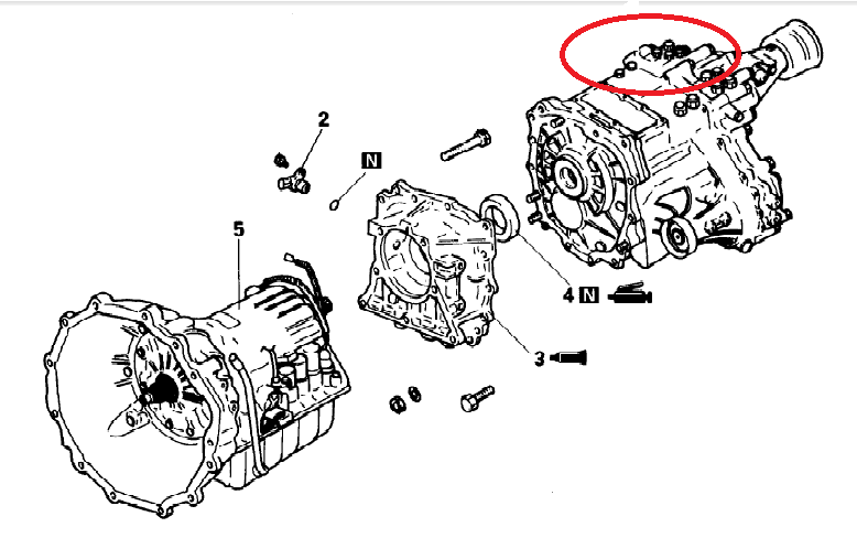

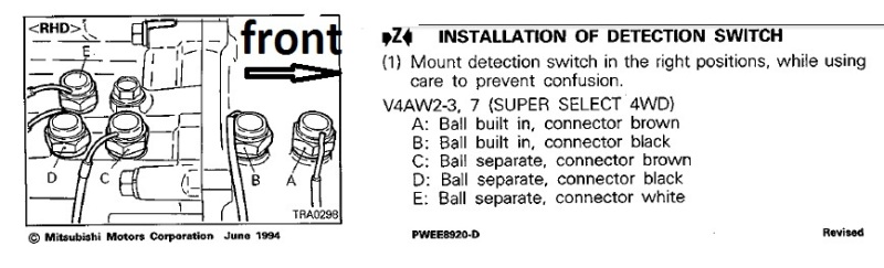

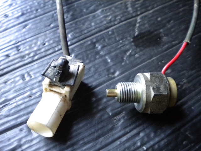

So the jokers at the dealership suggest that there are 5 sensors in the Super-select transmission and that there is another sensor which is causing a disturbance (but refused to do anything about it for me). Of course all their fiddling was probably the reason the sensor/transmission is pooched. They believe that it is this one (shown as E in illustration):
Super-Select problems

Sorry, one addendum to the original post: the sensor pictured is shown as "E" in illustration
4H-yes
4HLc-don't think so, all wheels still turning..."SOMETIMES it is possible to shift from 2H to 4HLc directly without shifting the transmission into neutral" suggests no cd lock
4LLc-can't get the shifter into position
