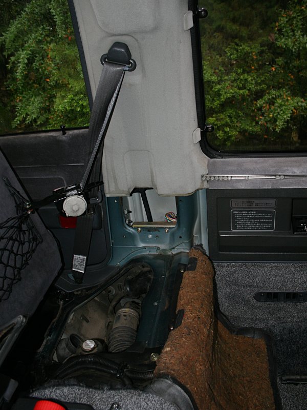

Post by marsgal42 »
I reinstalled the controller board (inside the gold-coloured housing in the B pillar) in Gumdrop:
Reinstalling the glowplug controller.
and she roared back to life after the expected two clicks. 8-) 8-) 8-) 8-)
Removing and reinstalling the controller just requires a certain amount of dexterity, as well as 10 and 17mm sockets. Repairing the controller requires some electronics background. If you don't know what you're doing, ask a mechanic. This is probably a once-in-a-lifetime repair - fresh new capacitors should be good for at least another 15 years. I know what I was quoted for the repair, but your mechanic may quote something different, and I ended up doing it myself anyway.
Diesel engines work by sucking in air, compressing it so it gets hot, then squirting in fuel to initiate combustion. When the engine is cold the heat of compression is dissipated in the engine, and it never gets hot enough for combustion. The glow plugs guarantee a small area of the combustion chamber that is hot enough for combustion. With the relatively mild weather at the moment you could probably start your Delica without the glow plugs (crank enough until things get warm inside), though it will be hard on the starter and battery. The controller gives the glow plugs lots of current at first, then a smaller amount while the engine is cranking. It may continue supplying current to the glow plugs for a few seconds after the engine starts. It all depends on the air and engine temperature.
If the Mitsubishi engineers thought they could do without the glow plugs (and save a few yen at manufacture), they would have deleted them and the fancy controller that makes them go. They are there for a reason.
...laura

Hi, as i said before in other glow plug fix topic, its located in the driver side center pilar under the seatbelt as laura finally find it,
you just need to find a right person who knows about electronic board, after that its easy.
