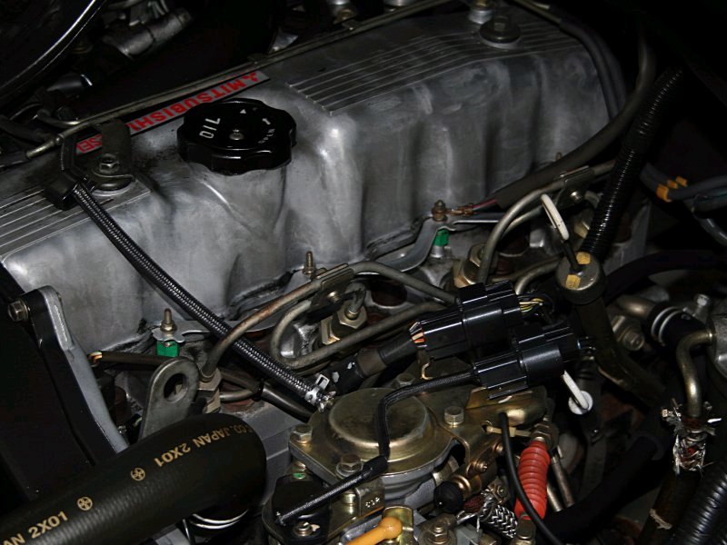

Here's what you're looking for. The glowplugs are the components with the green insulators, right next to the injectors.
Closeup of injector pump and glowplugs.
The bus bar is the curved electrical connection between them. These things draw a lot of current when they're operating. Since repairing the glowplug controller last weekend I see that the lights don't dim as much as they used to. Maybe the controller was slightly haywire all along, running the glowplugs at full power, whether they needed it or not. :shock:

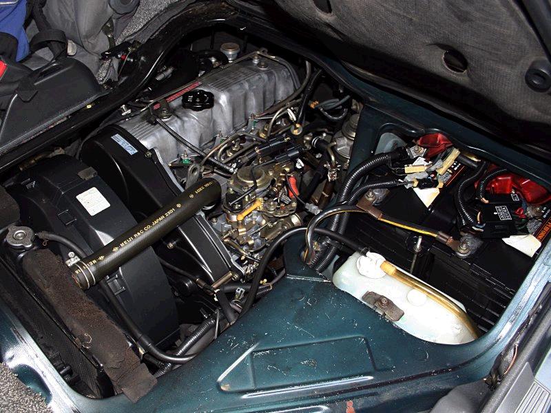

To help find your way in, here's a wider shot of the engine bay.
