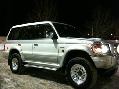

I am also a bit unsure where the little reflectors should go... as seen in the photo of the Paj (bottom of page) http://www.delica.ca/forum/what-did-you ... 03-90.html, there are those little reflectors middle of the quarter panel under the Exceed badge. Granted, they were a bit dirty from the shite conditions at present, so I am guessing they want them elsewhere.

Re: '95 Pajero Q.
Thats where they should go, most new North American cars have built in reflactors in the side of the head and tail lights. so you want one yellow one close to the front signal and one red one close to the back tail light. I've circled where they should be. you can see the round yellow one on the front. they can be round or rectangular but have to be there to pass.
And to Glenn Its all good... Safety is important to me too and I should put the back reflector on, just need to find one that looks like it belongs there...
