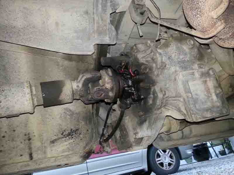

Does anyone here have some helpful tips on replacing the transfer case seal , part number, where to get ,what is the oil in it and how much do I need , any help much appreciated.

Ive got a simmilar leak, but i dropped the t case fluid while doing my front drive shaft u joints, it takes around 2 liters of gear oil, i just used synthetic 75w90 or whatever, i ended up using a syringe and a hose to inject the fluid into the case, it worked better than the pathetic bottle pump i bought.
hope this helps. im interested in the seal P/N as well, i will keep an eye on this.

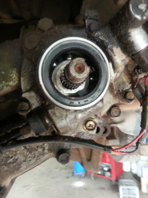

So, just replaced the seal yesterday, well i watched my mechanic do it i should say!
Here's a run down of what's involved: Jack up the back wheels, (hoist works wonders) make sure you're in neutral with the e-brake off (you'll want to be able to rotate the rear drive shaft)
Undo the four bolts and nuts connecting the driveshaft to the transfer case (the yoke) and you'll need to remove the ones on the diff side yoke too, to remove the shaft.
Once that is out of there you should be looking at the piece on the transfer case that the yoke connected to, it is removed with a 17mm (i believe) socket, then the unit should slide out revealing the splined shaft and pooched seal.
The part number i took off the seal we 15Z 50 68 9 AE. The Mitsubishi part number i had found earlier and crossed to a 21108 was wrong. The 21108 was a 1/4 inch wider than necessary.
I took mesurements to napa and picked up a 19569 which fit perfectly. A Napa 19610 or 19620 would probably also work as they should just be thicker across. I took the one they had in stock.
Once the seal is in (tapped into place with a hammer, gently) the splined yoke piece can be fitted back over and all can be reassembled.
Hope this helps!
There is a large nut in the center of the transfer case when looking fron the rear, above the level of the driveshaft, with this removed (17mm, again i believe) you can put an allan key in there and check for fluid level, my mechanic filled it with gear oil until it just started showing on the allan key when inserted and pointed down.

- view of the old seal after removing the driveshaft and yoke. Inside diameter is 50mm.
