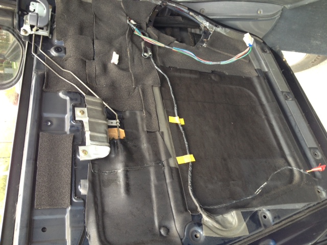

Seems like my front door lock actuator died today :(
At least thats what I think happened.
I (very) carefully removed the door paneling to investigate. I came across tons of mastic insulation in the door panel which made further investigation impossible. If anyone else has removed door panels, have you seen this kind of sound insulation?
I have to peel some out to access the mechanism. Does anyone know where more insulation can be purchased?
Thanks for your help.
Jamie.

But here is a different, question: Has anyone ever had to repair/replace the lock actuator?
Scenario: I noticed that the van was trying to lock the doors at +20kmph (normal), but it kept trying.
I figured that the reason was because it detected that the passenger side was still "unlocked" position.
I pushed the Lock/unlock button a few times and the passenger door did lock/unlock sometimes, but it seemed to "struggle" even when it did lock.
My conclusion is that its definitely getting power.
Perhaps the motor is giving up?
Perhaps there is too much physical resistance?
Once I got the panel off, I blasted some silicone spray, but to no avail.
Your thoughts are appreciated as always.
J
