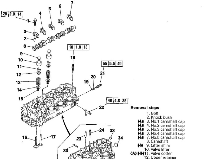

Lots of people seem to think the 4M40 has hydraulic lifters. They don't however.
The valve clearances on the 4M40 are adjusted by shims. The adjustment is a bit of a pain to do, but you can start by checking them easily enough to see if they are out.
Remove the cam cover and turn the engine using the crank bolt CLOCKWISE ONLY until the lobe of the cam of the valve you wish to check is pointing upwards. Slide a feeler gauge under the cam (between cam and lifter). The clearance you are looking for is 0.2mm for inlet and 0.3mm for exhaust (cold).

Re: Injectors
shims up top #9
- ValveClearance.jpg (13.5 KiB) Viewed 10318 times
- Camshaftandshims.jpg (91.62 KiB) Viewed 10318 times

Re: Injectors
Didn't go out and pull a lifter yet this morning, but I did take a look through my service manual, and I am indeed wrong. There are 37 different thickness' of shims in .025mm increments, ranging from 2.250mm-3.150mm. A good reminder for me not to always assume that I have been given the correct info, and to check it out for myself. I emailed my friend in England just to let him know the info he had given me was incorrect, but he may have already found it out. Sorry for steering you wrong. I'm not going to edit my previous post, as I do not try and hide my mistakes, I admit to them, and try and correct them as soon as possible. Thanks for correcting me on this Diver. So there is indeed a procedure for setting the valves on the 4M40, which involves measuring the tolerances, changing the thickness of the shims if needed, remeasuring, and repeat if necessary until the proper values are achieved. While I do hate being wrong, I'm sure glad I'm not perfect. The last perfect man was crucified. I will however, continue my quest for perfection, knowing I will never achieve it.
