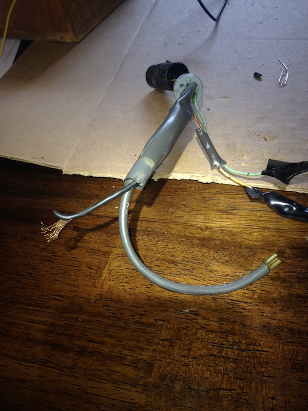

I finally sorted out the clicking and it wasn't a solution I had heard on any of the forums. I always suspected part of the electrical problems were due to moisture. The van spend 2 months at sea being shipped over from New Zealand and when I picked it up there was mold growing everywhere. The previous owner never had any electrical issues or clicking. First clue.
Second clue was that one day my glow plugs didn't click upon start, which was a first. I moved the 2 wires around leading into the temp. control sensor and it worked again.
I ended up pulling the loom out and rebuilding it completely. I used this as a rough guide - http://www.benzworld.org/forums/w140-s- ... -step.html
Although it was much easier since there were only 3 wires. New wires and re-soldered the ends. I don't have a finished picture but took about half a day since I was being very diligent. Success! No more clicking.
Old loom.
Old loom.
