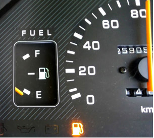

Re: fuel tank question
I finally got around to figuring out why my low fuel light never came on- turns out it was perfectly functional, I just never ran it low enough. Usually I get nervous and fill up when the point of the needle reaches the lower part of the Empty mark.
Most vehicles I'm familiar with turn on the low fuel light just before the gauge reads Empty. This is where my gauge has to be before the light comes on:
There has to be something wrong here. I travelled another 150km between the lower end of the E mark and when the light came on. What's the point of a fuel gauge if Empty doesn't mean "empty"?
