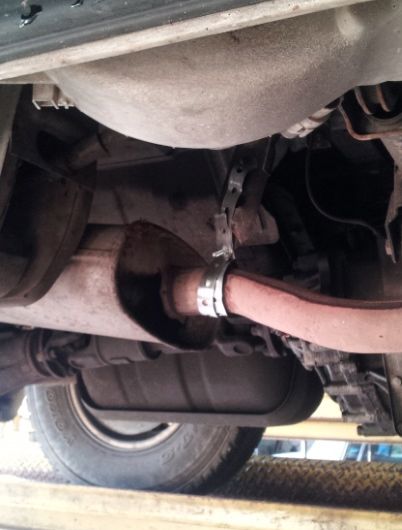

SvR needed some exhaust work recently and very quickly. Not quite two years ago I took the less expensive (and rougher) route and had a friend help install a muffler. A few days ago I noticed a weird noise coming from the driver's side rear. Thought of a few things. Mostly loose lug nuts. After wheel removal and inspection I saw that my muffler mount was broken and the poor bugger was just hanging there, severely cracked from the strain.

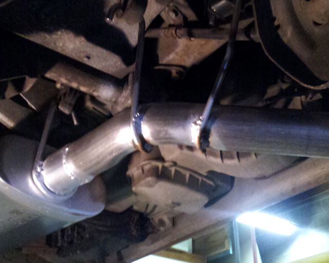

A little time spent here (Delica.ca) gave me plenty to think about. Time to go to 2.5", Side shot and a much better can. After much reading I decided to go with Hoegler's in RIchmond. They didn't have the Magna-Flow I wanted but said they could have one in the next day and to drop on by.
The mechanic there said he had done at least 3 Deli's in the past week and had another coming the next day, so I was quite comfortable when he showed me exactly what he was going to do.

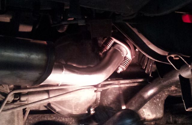

Cut and weld from the header coupler (wear the exhaust spring attaches to the header) - Magna-Flow inline then a bend and slip it out the side in front of the rear wheel. Only need to drill one hole in the frame to attach a hanger.

Old exhaust hanging in there - just
Deli old exhst.jpg (34.57 KiB) Viewed 1456 times
2.5" of flow
2.5" of flow
Deli new Ex 1.jpg (39.77 KiB) Viewed 1456 times
Nice Hangers
Nice Hangers
Deli New Ex 3.jpg (43.26 KiB) Viewed 1456 times
