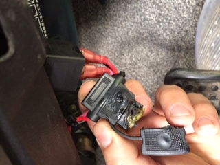

I have been smelling burning plastic in my Super Exceed on and off for a while now. Finally found the source... any ideas what the hell this is?
It's located under the steering next to the fuse box. Its covered with a black rubber case with a lid. Under the lid there seems to be a melted fuse... not sure what the hell it is or what it does.
A red wire goes into it from one end and comes out the other side and into a black cube. The black cube has 4 wires plugged into it.

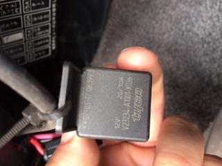

- Whatever the melted black thing is, it's attached to this thing.
- photo 4.JPG (35.25 KiB) Viewed 3973 times

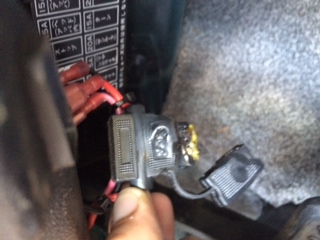

- Another angle. You can see how melted it is and the red wire that plugs into a black cube thing.
- photo 3.JPG (41.48 KiB) Viewed 3973 times

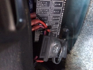

- There is a rubber case around the whole thing... the yellow you see looks like a melted fuse.
- photo 2.JPG (39.1 KiB) Viewed 3973 times
- The melted rubber thing closed. It's located next to the fuse box under the steering column...
- photo 1.JPG (39.13 KiB) Viewed 3973 times

Looks like a fuse into a relay. Probably something someone else has installed. Lights, fog lights , stereo...everything still work?

Looks just like the aftermarket fuse I wired off my battery for my driving lights, backup lights and rewired cigarette lighter.
Something must have shorted to ground for that much heat.

Yeah I thought it might be some aftermarket fuse, but what the hell it's for? I'm at a loss. I checked everything out, lights stereo, wipers, fans, dash lights... everything seems to be working, no warming lights. I haven't installed any after market bits.
It's a freaking mystery. It's seriously melted, and was quite hot to the touch, so it does concern me. Especially if it's for something that I might need in a pinch.

Do your DRL's still work? That looks like a system I've seen before.

Indeed my DRL's are out!
Damnit! So, mystery sorted... now, anyone recommend somewhere in Vic that can fix it up?
Or for a handy guy, not so knowledgeable about mechanics and even less about electrical systems... any idea how to fix it?

any mechanic should be able to do this pretty standard for USA imports...
Personally I would just turn on the lights with the engine (no legal but is safer with the tail lights anyhow)... but you need to remove power from this vehicle fire first
